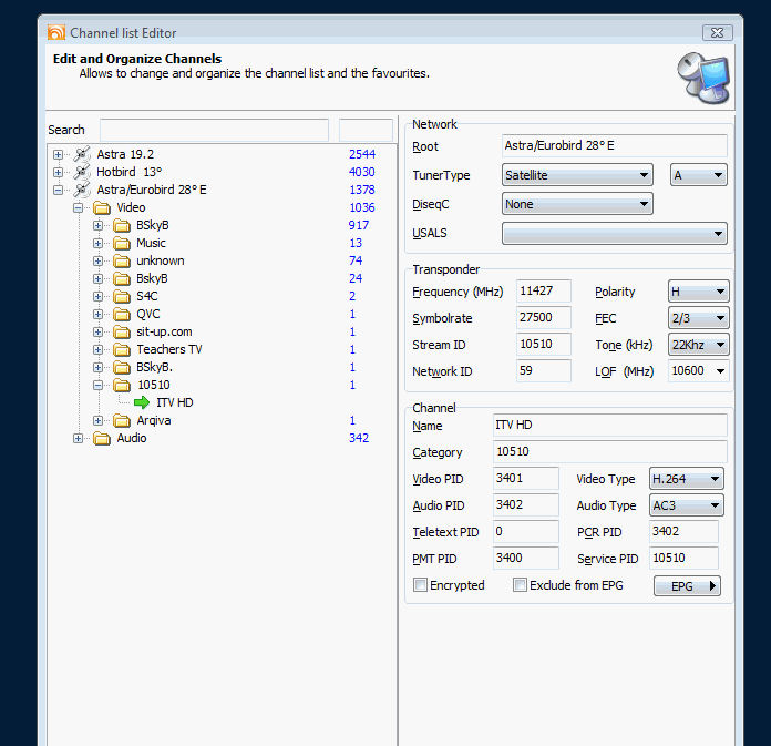

Eurobird 1 , 11.428 GHz horizontal, symbol rate of 27500
SID 10510
PMT =3400
Vpid=3401, H.264
Apid=3402, AC3
You have to bend the video_stream_type to 0x1b :original:
http://forum.dxtv.de...98340#post98340

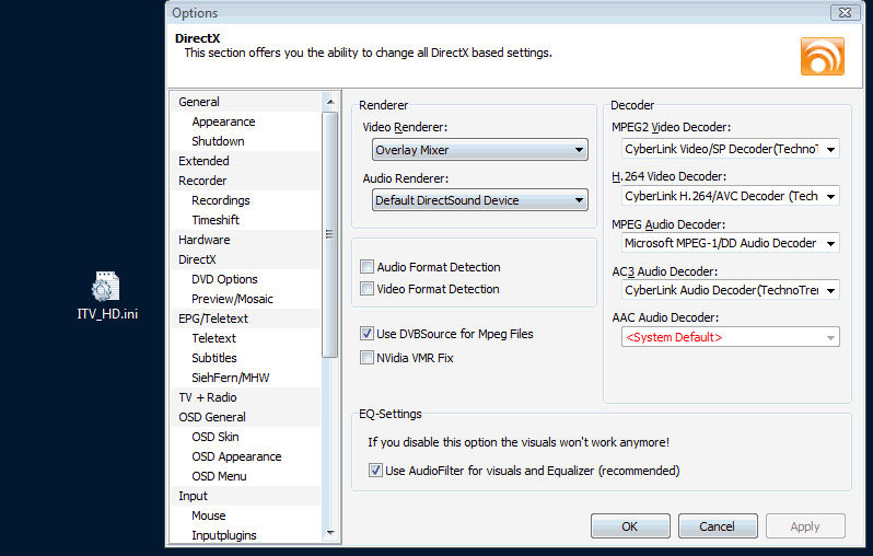

Attached an INI file for importing ITV HD in the DVBViewer channellist. Adjust DiSEqC and channel group to your settings, if necessary.
In DVBViewer GE channel auto update must be switched off, otherwise the video type will be changed to MPEG2. Or set the Service ID to 0, in order to prevent DVBViewer GE from finding the PMT.

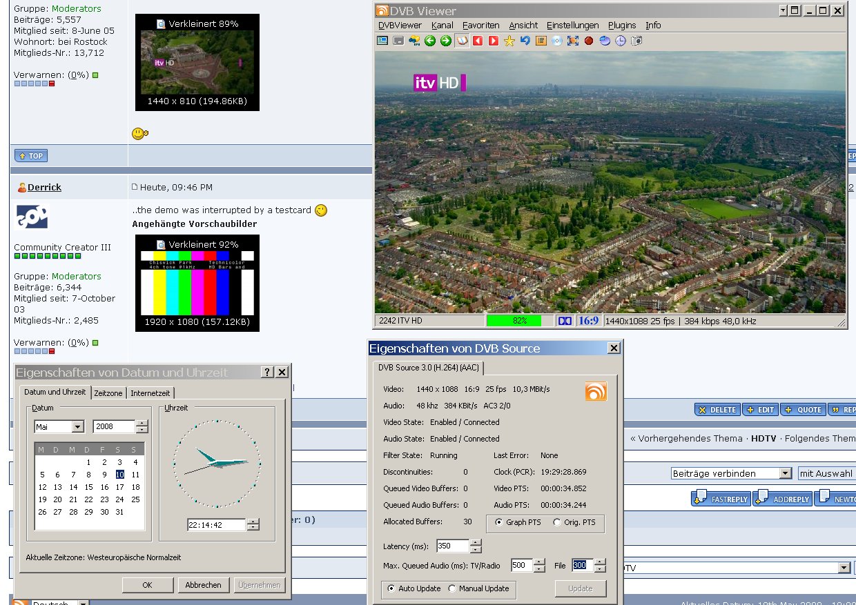

Many thanks for the very useful info in this thread ..
ITV Picture and sound just fine on my s2-3200 card ...
I guess its just a question of waiting for the rolling demo to be replaced with some actual programming..
..and using the s2 card avoids having to splash out £150 on a dedicated box..
:original:
Just out of curiosity ..can the stream be processed on a standard SS2 card .. ?
..or does this card lack the neccessary hardware ?
