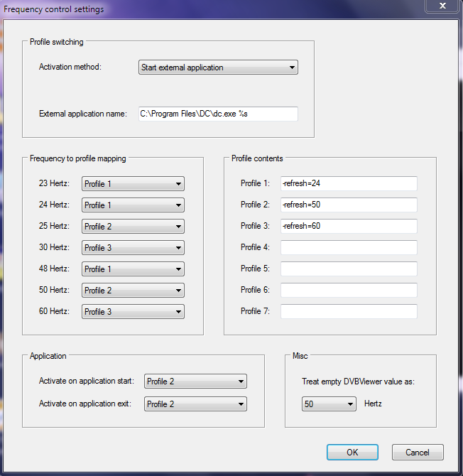

I'm using the plugin with Display Changer 4.3.1 and it's working great.
Is there a way to make refresh rate change only when switching between two different "frame-rated" contents? IE, avoid change when zapping channels that have same refresh rate?
Some kind of control before start switching operation: IF new frame-rate != old frame-rate THEN change it! Zapping between channels would be lot faster!

Is possible to add another feature to improve the plugin?
I would like the plugin restore a deired refresh rate on stop video or video end.
Example1:
My basic refresh rate for tv channel is 50HZ.
I launch a 24HZ video then plugin changes the refresh to 24HZ.
I stop the video or video time end then "the plugin changes the refresh to 50HZ"

The plugin does this already by itself...
If you stop the video, it will show the last tuned channel and switch back to 50hz.
Also, you can configure that when you exit DVBViewer it switches back to 50hz also.
Using display changer DVBViewer shows last tuned channel, but don't switch back to 50hz, it switch back only after channel change. Using only this plugin where is no profile 24Hz in nvidia video card, card supports 23,24,30,50,59,60

tool isnt working with sandy bridge intel grafik, nothing is happened when switching the frequence
Try it as I write with 12noon display changer, it's working, but one problem is after end of watching video and switching to TV, refresh rate didn't change to 50Hz, you must change the channel +/- to come back refresh rate to default 50Hz. The path to dc.exe must be correct, it can be different.

i tryed DC, but i have one problem, how can i set the correct monitor? when i do dc.exe -listmonitors, i got device: \\.\DISLPAY1 and \\.\DISPLAY3. What i have to do, that the tool switch the correct monitor?
Link to comment
