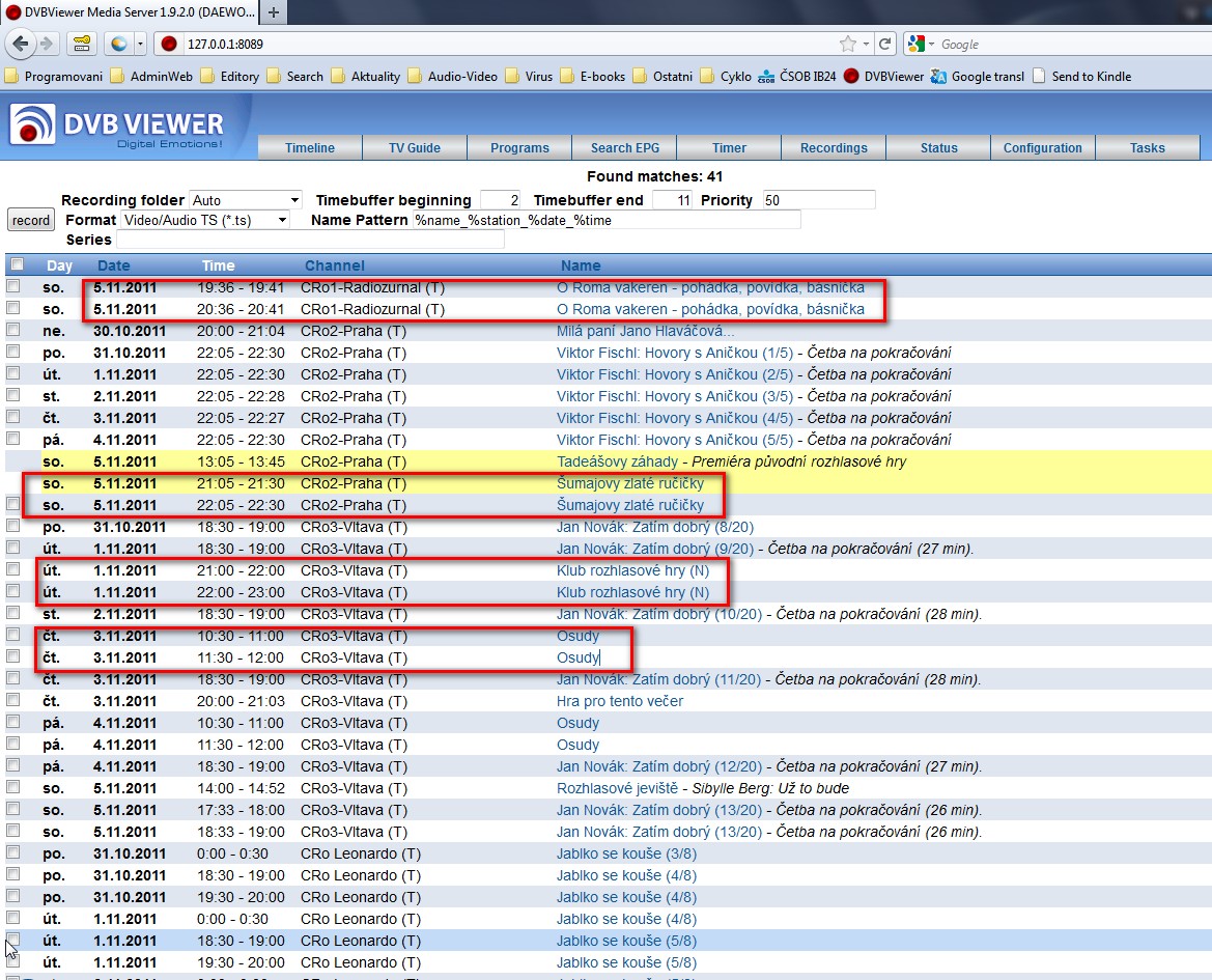

DST moved time and i have the same problem now , in EPG some items are duplicated with a shift back one hour. Other items are OK. What I can do it?
