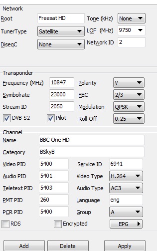

daveuk Posted September 30, 2012 Share Posted September 30, 2012 (edited) none of the above works for me. any other ideas? I have lost bbc 1 hd and bbc hd. I have also tried editing manually in DVBViewer. See attached jpg Can anyone upload a working ini for the BBC HD channels? Edited September 30, 2012 by daveuk Quote Link to comment
Griga Posted September 30, 2012 Share Posted September 30, 2012 Modulation must be 8PSK, not QPSK! Sorry, my mistake - now corrected in my post above. Quote Link to comment
daveuk Posted September 30, 2012 Share Posted September 30, 2012 Modulation must be 8PSK, not QPSK! Sorry, my mistake - now corrected in my post above. thanks, working now!!!!! Quote Link to comment
