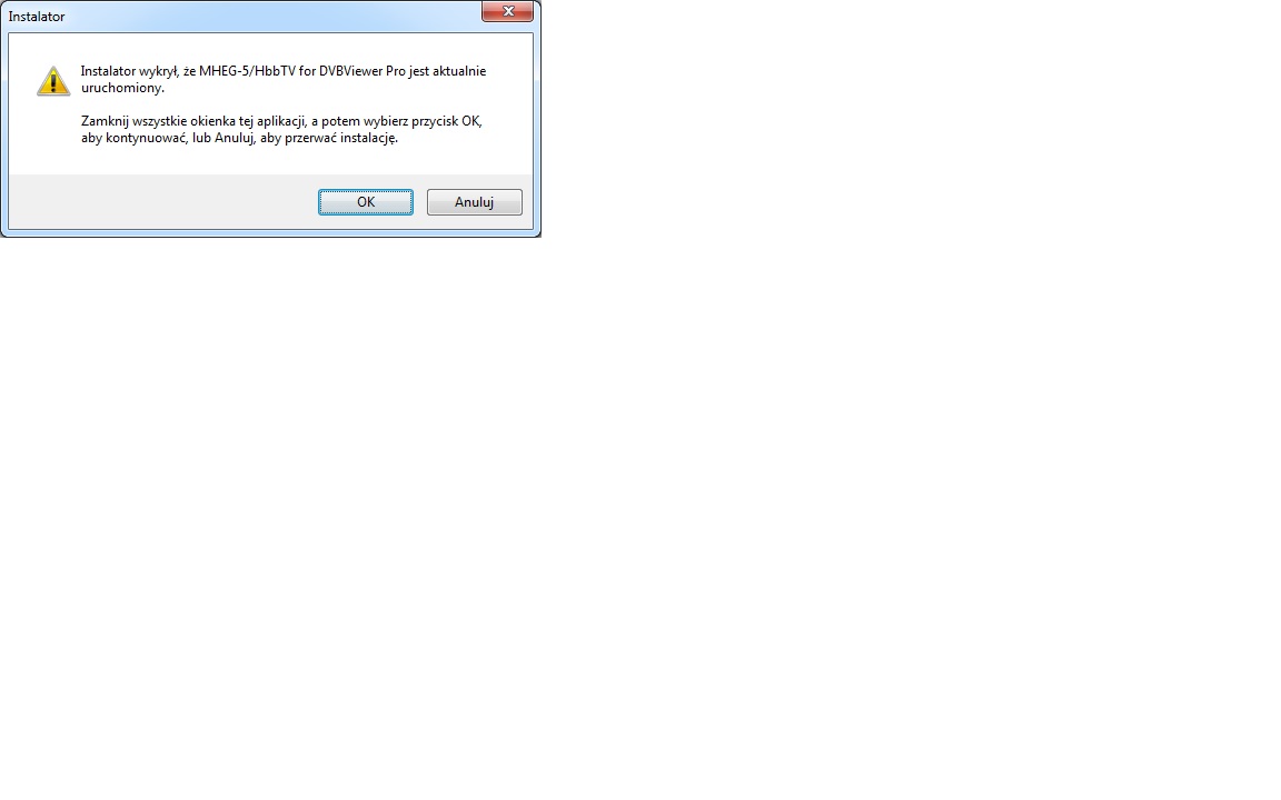

bjanuszs46 Posted October 5, 2015 Author Share Posted October 5, 2015 The HbbTV/MHEG 5 Engine is not installed on your system. So it can't work. Go in the https://www.DVBViewer.tv/members/ Paid Additions download and install it. And it there is still a problem post a support.zip from the DVBViewer Pro in Debug Mode on the channel. In the Debug Mode (start menu > DVBViewer > Support > DVBViewer Pro (Debug Mode).) the DVBViewer writs additional information in the DVBViewer.log which a necessary to investigate HbbTV problems. When I try to reinstall HbbTV engine, the installer says the engine is already running. See the screenshot. I thin I was running DVBViever Pro in Debu Mode... Anyway I've prepared a new file. Best regards Janusz support.zip Quote Link to comment
Tjod Posted October 5, 2015 Share Posted October 5, 2015 Not the HbbTV engine is running but the DVBViewer or the RS. You have to stop all software which is connected to the DVBViewer before installing or updating a part of it. Quote Link to comment
bjanuszs46 Posted October 5, 2015 Author Share Posted October 5, 2015 The message said explicitely that this the HbbTV engine that is running, but actually it was Recording Service. I've realized that there is now a different icon for HbbTV, which was for me definitely confusing. Perhaps it worked all the time but I just didn't noticed it... Thank you very much for your help. Best regards Janusz Quote Link to comment
