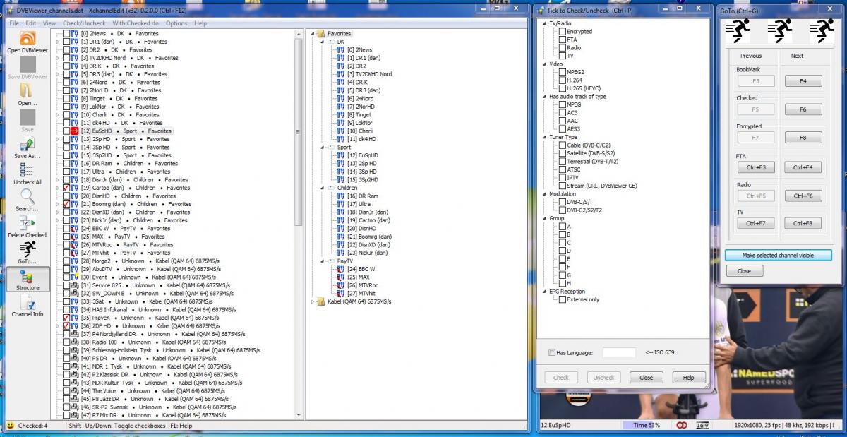

The Check/Uncheck -> By Channel Properties window reworked.
The GoTo window is now made non-modal, making it much more usefull IMHO.
You can now have a scenario like this
Changes in one window is automatically reflected in the other windows.
Details in Changelog link (new) at XchannelEdit home.
