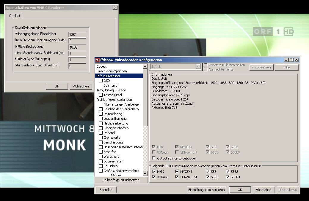

CiNcH Posted September 26, 2008 Author Posted September 26, 2008 (edited) Here is some more experience with ffdshow H.264 and DVB: no multithreading with non-sliced material, 100% CPU load for Anixe HD for example on core 2 with a C2D 2.13 GHz -> async audio, freezes a.s.o. (not much performance is missing though, on a C2D with 2.67 GHz it already worked flawlessly, however without deinterlacing...) 1080i works perfectly with a CPU load of 60-80% when H.264 deblocking is disabled, again without deinterlacing being applied (so if you experience performance problems do that as well) 720p50 ORF 1 HD works perfectly, load is equally distributed on both cores (40-50% on the C2D 2.13 GHz), their encoder seems to take advantage of the slice concept switching from 720p50 to 1080i on the fly without graph rebuild is no good idea, ffdshow may crash, to work around it, enable video format detection within DVBViewer And a quote by Dark Shikari (x264 developer) from yesterday: libavcodec is now actually significantly faster decoding in singlethreaded mode (and the mt branch provides multithreading, which will be merged soon) So the future may not look too bad. Edited September 27, 2008 by CiNcH Quote

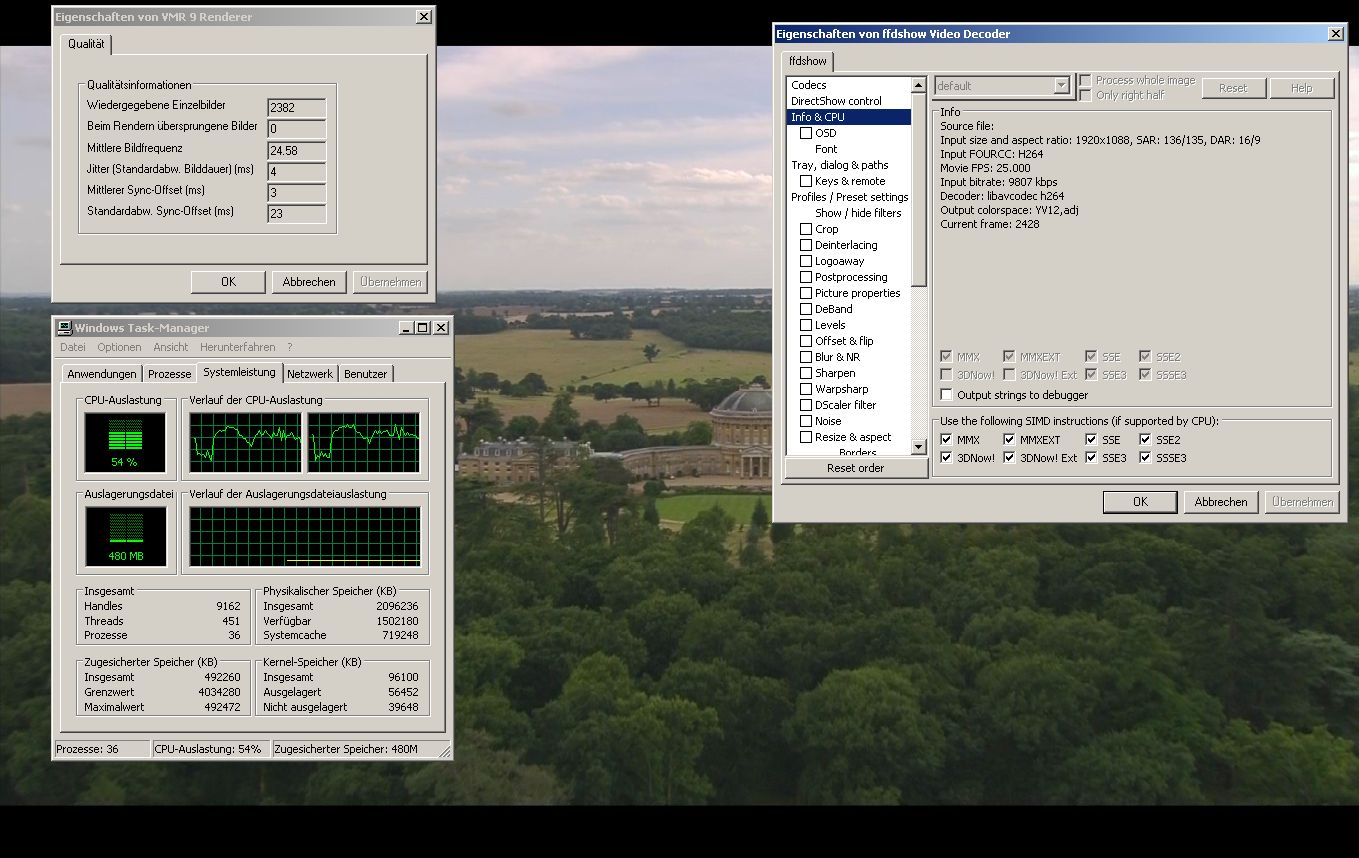

CiNcH Posted October 17, 2008 Author Posted October 17, 2008 (edited) It is getting better and better Now with ffmpeg-mt, 1080i Anixe HD with H.264 deblocking enabled: This is live with DVBViewer on Anixe HD. It somehow crashes on 720p channels like arte HD and ORF 1 HD. Recorded files from the same channels work fine. Edited October 17, 2008 by CiNcH Quote
