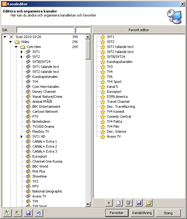

Can you post a screendump on the DVBViewer channellist (editor)?
Maybe the new stations went into a different folder from the original scan.Another possibility is that the operator gave these new channels different "Network" names in the descriptor.

Please see attached picture. TV3 is one of the new channels.

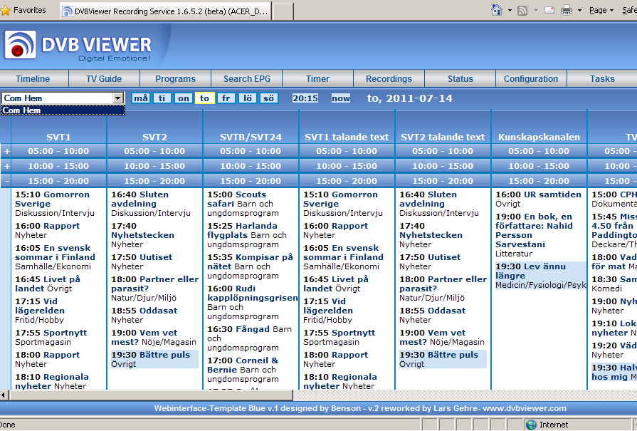

I only have one option in the dropdown menu (see attached picture) "Com Hem" and that matches the folder in the channel editor (see attached picture). Please note that, strictly speaking, my cable-TV operator did not add any channels, rather I started subscribing to 2 more channels that already where found in my last scan. Therefore, I did NOT do another scan after I started subscribing to the 2 "new" channels.
Thanks for the dumps, but unfortunately it didn't show the last bit of the channellist, where the duplicate folders tend to be placed. I had the same theory as Cian you had the new stations placed in a different folder and that's why you have this issue, but i'm not sure in any way. Only thing i can think of to do here is to delete the whole channellist and start from scratch with a new scan. Might be wise to use Transedit for the scanning instead, since Comhem has channels that DVBViewer seem not to be abled to find, e.g. SVT2 HD.
