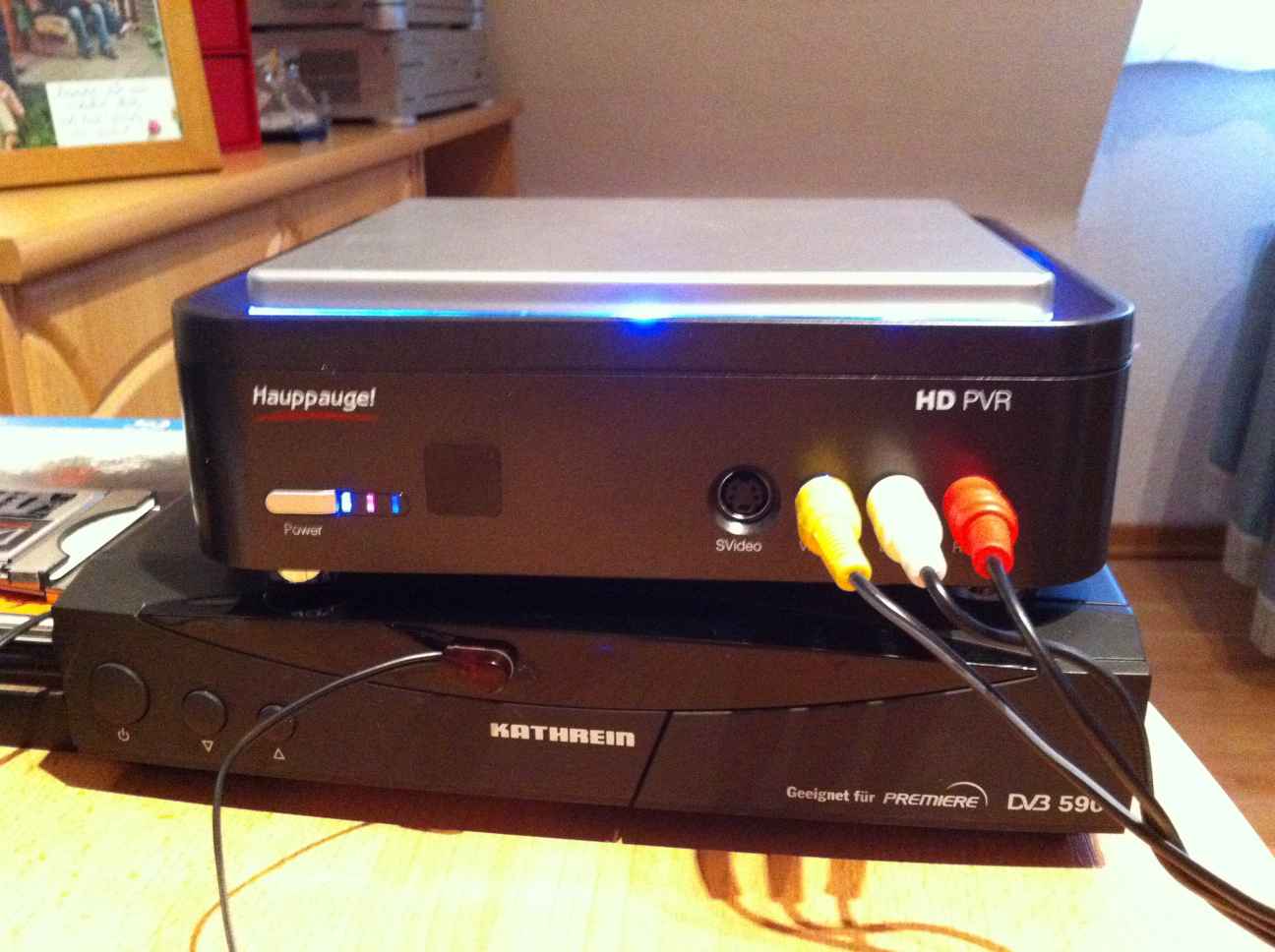

i received several emails concerning this box in last weeks, and to be honest integrating it took longer than i expected. The reason was a combination of lack of experience to add such a "thing", which is technically nothing else than a DA/AD convertor, but the fact that the delivery service was unable to do its job :(
Anyway i'm happy to announce that the next version of the DVBViewer will support this device.

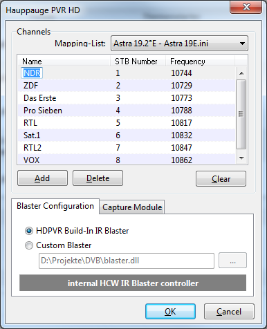

All you have to do is to create a mapping list for each adapter you installed and to set up the video and audio source, resp. to select the IR Blaster you want to use. You will be able to choose between the build in blaster device, or a plugin. I will publish the interface once it is complete.
Once you did this, you can scan for the channels which where added as normal dvb/atsc channels inside the DVBViewer. There is only one thing which wont work: The epg data has to be imported, since the Hauppauge device is not a regular DVB/ATSC adapter.
