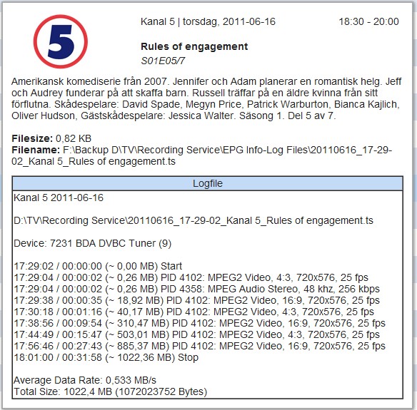

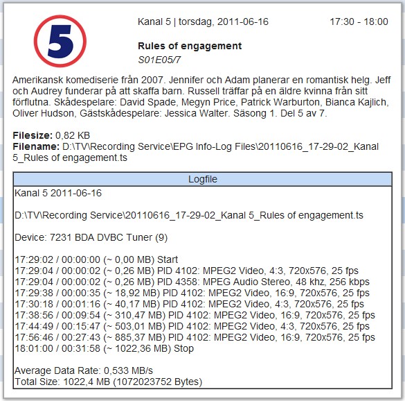

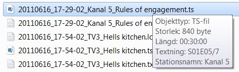

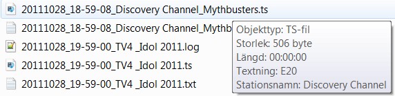

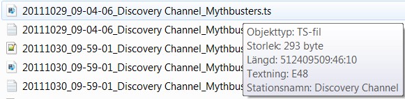

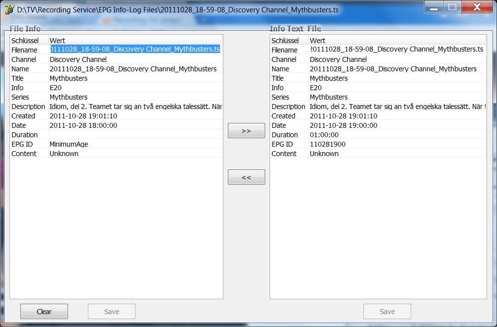

majstang Posted November 3, 2011 Author Posted November 3, 2011 (edited) Ok, i finally found some massive proof this is a wintertime change bug by using the delprops tool. FileInfo view was identical to the Info text File before wintertime change. After it the fileinfo view has changed and there's an hours difference. Notice how this affects the duration time...it goes completly haywire. Negative values in svcdatabase and strange numbers in explorer view. Also made some screendumps on the zeroed out durationstimes...i.e those files/entries never show up when rebuilding the database. Not one single corruption of any dummy.ts that was created after the wintertime change has occured. Only affected files were created before 30/10. Edited November 3, 2011 by majstang
majstang Posted November 4, 2011 Author Posted November 4, 2011 (edited) After more investigations i now have a slightly clearer picture what happened. Seems the corruption of the fileinfo has going on continuously since 2011-09-24. All dummy.ts created between May and 24 of September got the fileinfo "Date" changed 1 hour back at the 24th. After this date the fileinfo date has been changed automatically when the recording was created up to 30/10. After the 30th of October the change of fileinfodate stops. Now the information txt file and fileinfo date corresponds with each other. The consequence for this one hour backward reset, one can see on the fileinfo durationtime. All shows with the duration time of 1 hour subtracted with the resetted hour equals 01:00:00 - 01:00:00 = 00:00:00 In other words all shows 1 hour long got the durationtime zeroed out, more than half my database disappeared because of this error. Other shows half an hour long did show up, but with a screwed up durationtime: 00:30:00 - 01:00:00 = 23:30:00 Thank god for the delprops application. I have now restored the fileinfo on all my dummy.ts and the database is back on track again. No fun maunally going over several hundreds of recordings. The only thing missing now is the most important thing...why this happened...i have no idea!? Any ideas? Unfortunately my svcdebug.log doesn't stretch that far back anymore, so no clues there. I will definitely keep an watchful eye on this one in the future. Edited November 4, 2011 by majstang

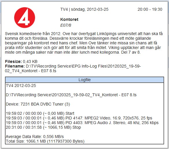

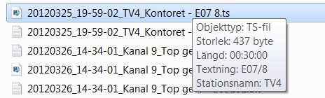

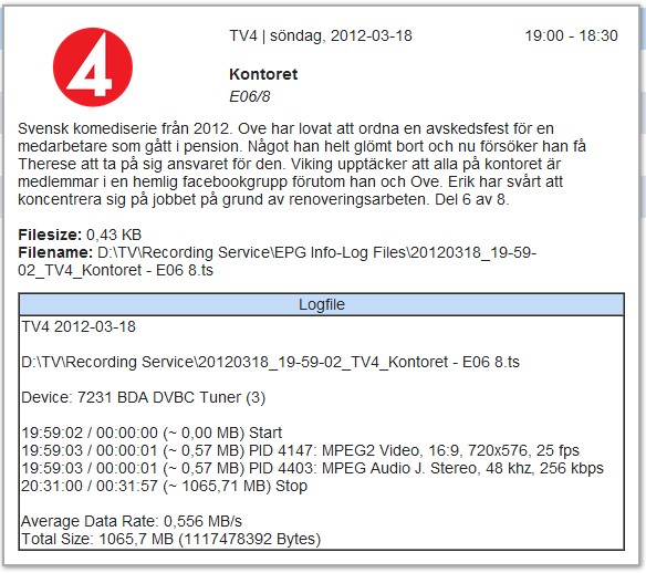

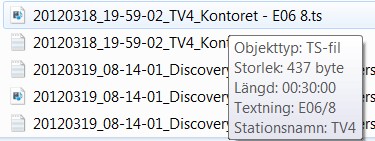

majstang Posted March 30, 2012 Author Posted March 30, 2012 Just cleared the previous recording history and deleted the svcdatabase (have to do it that way with this RS version) in order to rebuild both RS database and recording history. I did it to test if I got the same trouble with the fileinfo/properties as after the wintertime change (when the database went haywire and most of it disappeared). Results was disappointing sadly enough. As expected all fileinfo on the .ts recordings recorded before 2012-03-25 (visible in the balloon tooltip and the file properties in the explorer) got the length value added by 1 hour. A 1 hour show are now shown as a 2 hour show. All recordings made after the 25th has correct values. Now, contemplating the consequences if doing nothing since the lenght value plays no vital role (in theory) for the workings of the "check for previous recordings function". Simply leaving the wrong length untouched will render upon the next wintertime change, the value will go back to correct length (1 hour subtracted), except for those recorded after 2012-03-25. Most of these last ones will get thier length zeroed out and disappear from the database (if rebuilding it) like described earlier in this thread and the nightmare starts again completely sinking the "check for previous recordings function". Doesn't any solution exist for this annoying issue? Please do tell if there's any ideas how to fix it If there isn't why not remove the lenght value from the fileinfo/propeties all together until there is a solution at hand? I think this is a major problem when it causes so much trouble for the "check for previous recordings function". When having hundreds and hundreds of recordings in the database it's a daunting task manually changing the wrong values in the fileinfo every time when going from summer- to wintertime, in order to get RS back on track. regards majstang
Lars_MQ Posted March 30, 2012 Posted March 30, 2012 I found the problem. Consider it fixed. With the next release the start times and durations will be correct if read from the fileinfo. BTW I really hate your avatar, it makes me want to swat at my monitor...
