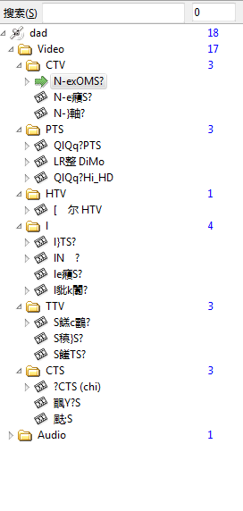

Channel table can not be displayed properly
DVB-T, Taiwan BIG5

Well it seems your broadcaster marks the EPG as Big5 but is actually transmitting it in the UTF-16 format.
EPG has been resolved, the search channel, the channel list is still unable to incorrect
