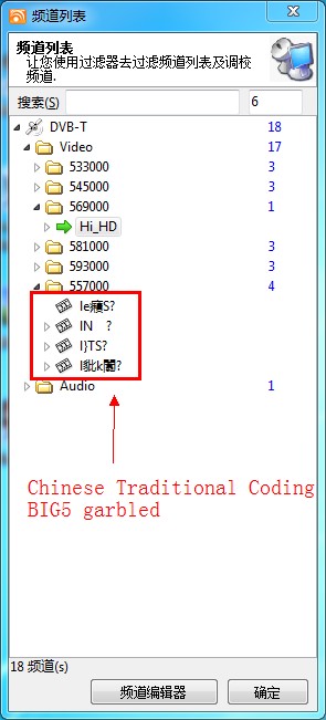

My system is the Simplified Chinese Windows 7, I watched the taiwan DVB-T TV when the name is a BIG5 show in my system is garbled

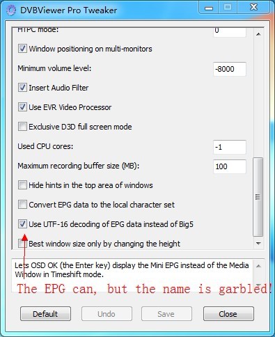

Hello, this can only solve the the epg garbage. Not solve the garbled name!

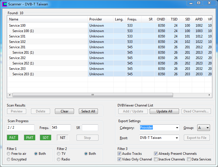

Display normal
I see. The test version is ok, but the release version 3.8.5 does not find the channel names. Correct?
Yes, release version 3.8.5 does not find the channel names

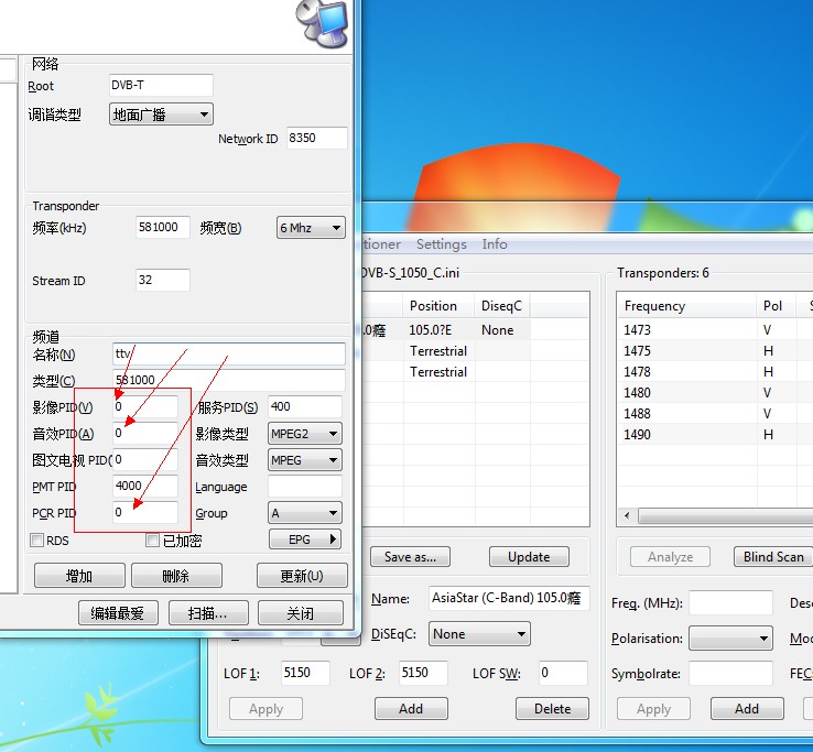

Recently, the DVB-T 581M frequency do not know what changed, 581M search out the PID is all zeros.
In TransEdit the PIDs on 581 are not zero. I can see it on your screenshot above (Mobile Radio).
The PIDs may be zero if you scan at a time when there is no broadcast.
This group of frequencies, three television programs. A broadcast.The other three television programs to search not!

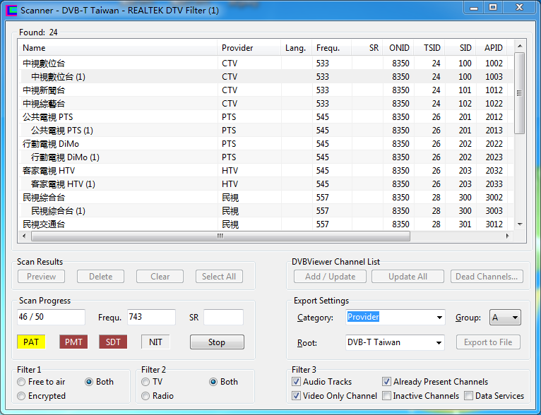

TransEdit 3.8.6 is now available in the members area.
For correct channel names in DVBViewer do the following in TransEdit 3.8.6:
- Select "Settings -> Assumed broadcast standard -> Unicode Big5".
- Switch "Settings -> Scanner 1 -> Update channel names in the DVBViewer channellist" on. Then click "Save".
- Use the TransEdit Scanner
- Click "Update All" in the Scanner Window, or select the channels that shall be added / updated, and click "Add/Update".

Use the "Inactive Channels" checkbox in the TransEdit Scanner Window. But the PIDs will be zero.
Your screenshot shows that TransEdit can not read all PID information. PMT is yellow, not green. Enter a higher value in "Settings -> Scanner 2 -> PMT Timeout", e. g. 10000 or 20000. I hope it helps.
TransEdit 3.8.6 is now avalable in the members area.
Now the program name will not be garbled.Today Taiwan to send maintenance personnel to repair. 581 program can search out.Two problems are solved, thank you very much help!
