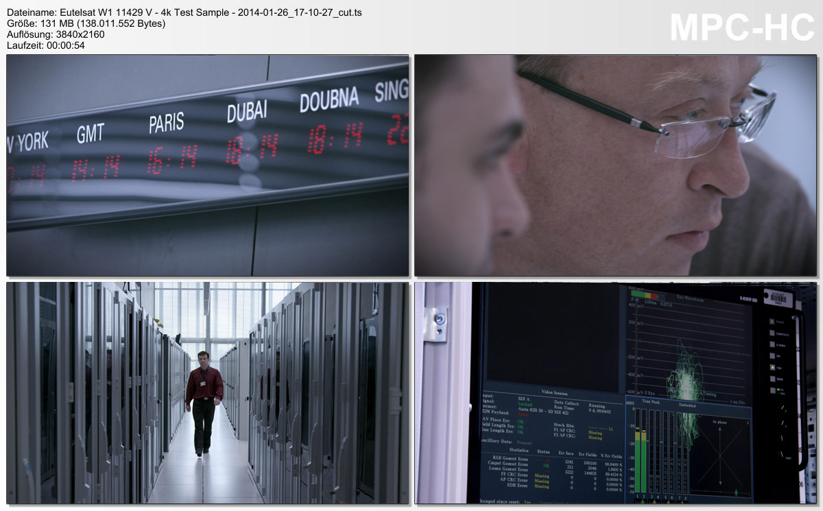

Eutelsat W1 11429 V - 4k Test Sample - 2014-01-26_17-10-27_cut.ts_thumbs.jpg
Video			: HEVC 3840x2160 60fps
File size : 132 MiB
Duration : 53s 469ms
Overall bit rate mode : Variable
Overall bit rate : 20.5 Mbps
UL Eutelsat W1 11429 V - 4k Test Sample - 2014-01-26_17-10-27_cut.ts
ZS Eutelsat W1 11429 V - 4k Test Sample - 2014-01-26_17-10-27_cut.ts

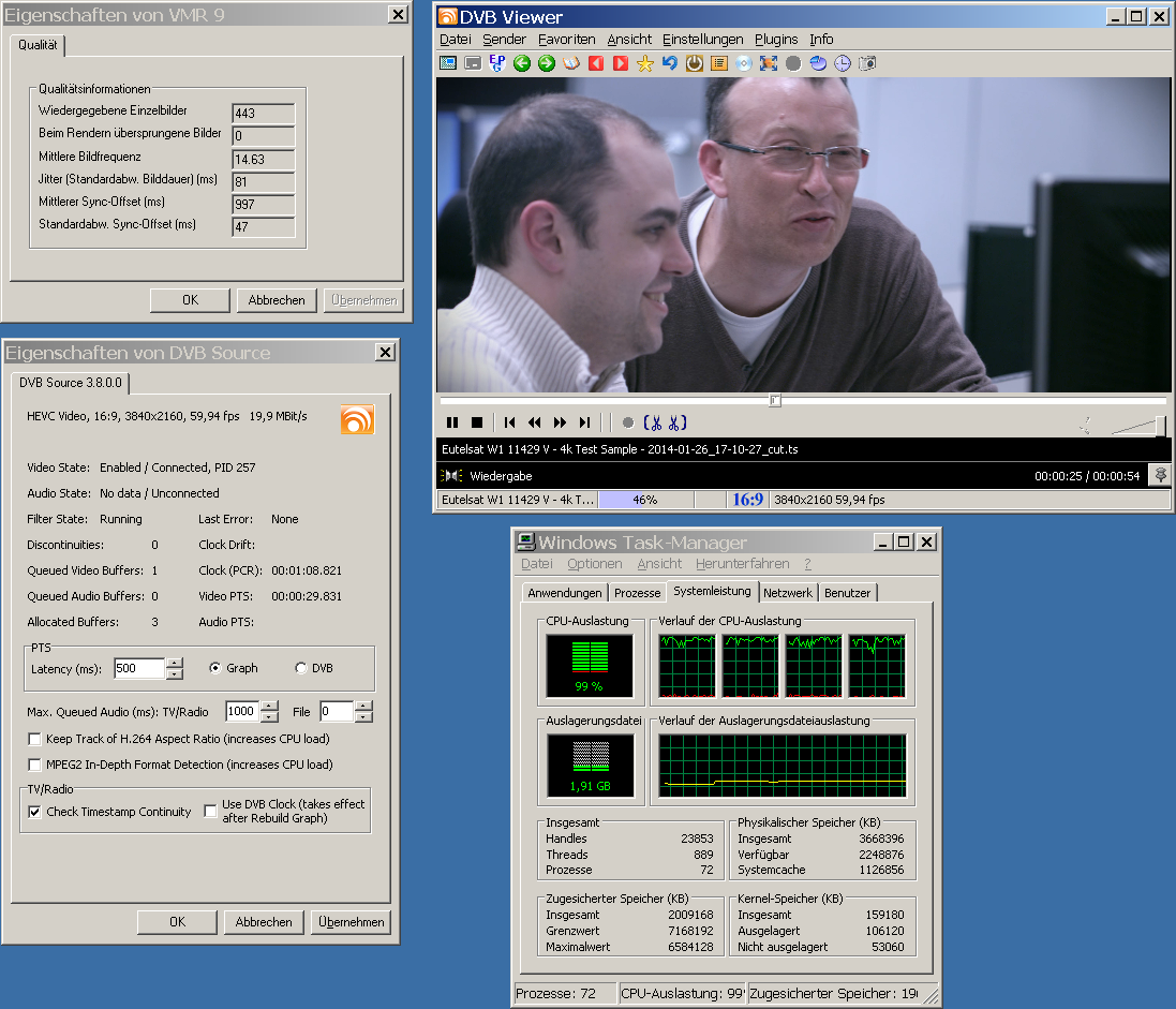

playback in DVBViewer GE on Windows XP with Intel Q6600 at 2,4 GHz, look at the frame rate ;)
Video Decoder was LAV 0.59.1
Eutelsat W1 11429 V - 4k Test Sample - 2014-01-26_17-10-27_cut_speed.jpg.png

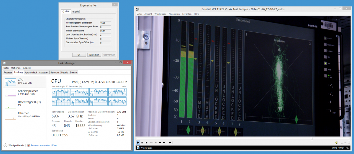

same video, other pc :D
quick and dirty build, no DVBViewer installed yet, only MPC
playback in MPC-HC.1.7.2.x64 on Windows 8.1 64bit with Intel i7 4770 at 3,4 GHz, look at the frame rate :lol:
Video Decoder was LAV 0.60.1.5
I've recorded the entire loop ;) My system: i7-3625QM @2.30GHz
LAV 059.1, rendering rate is very unstable (high jitter)

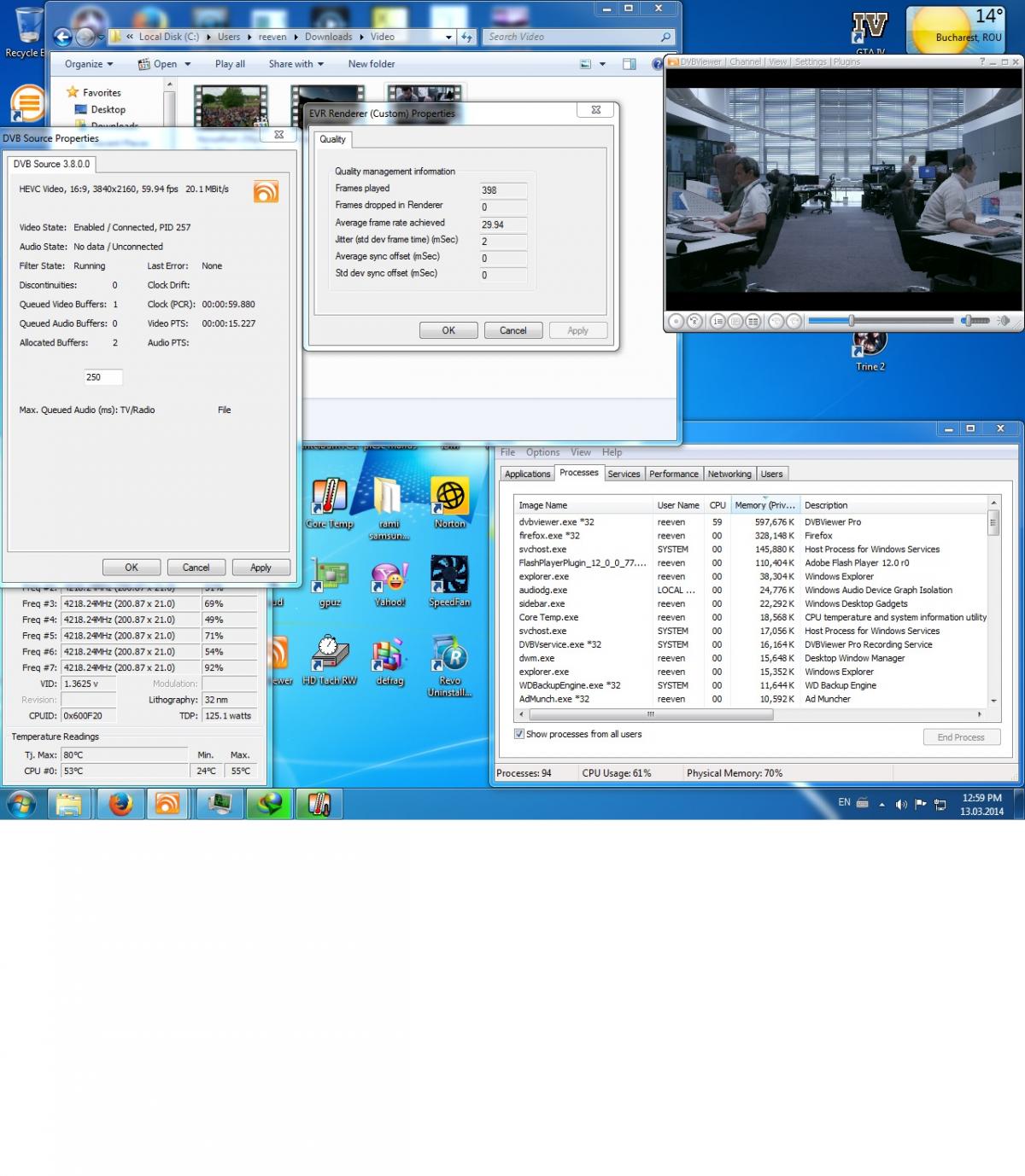

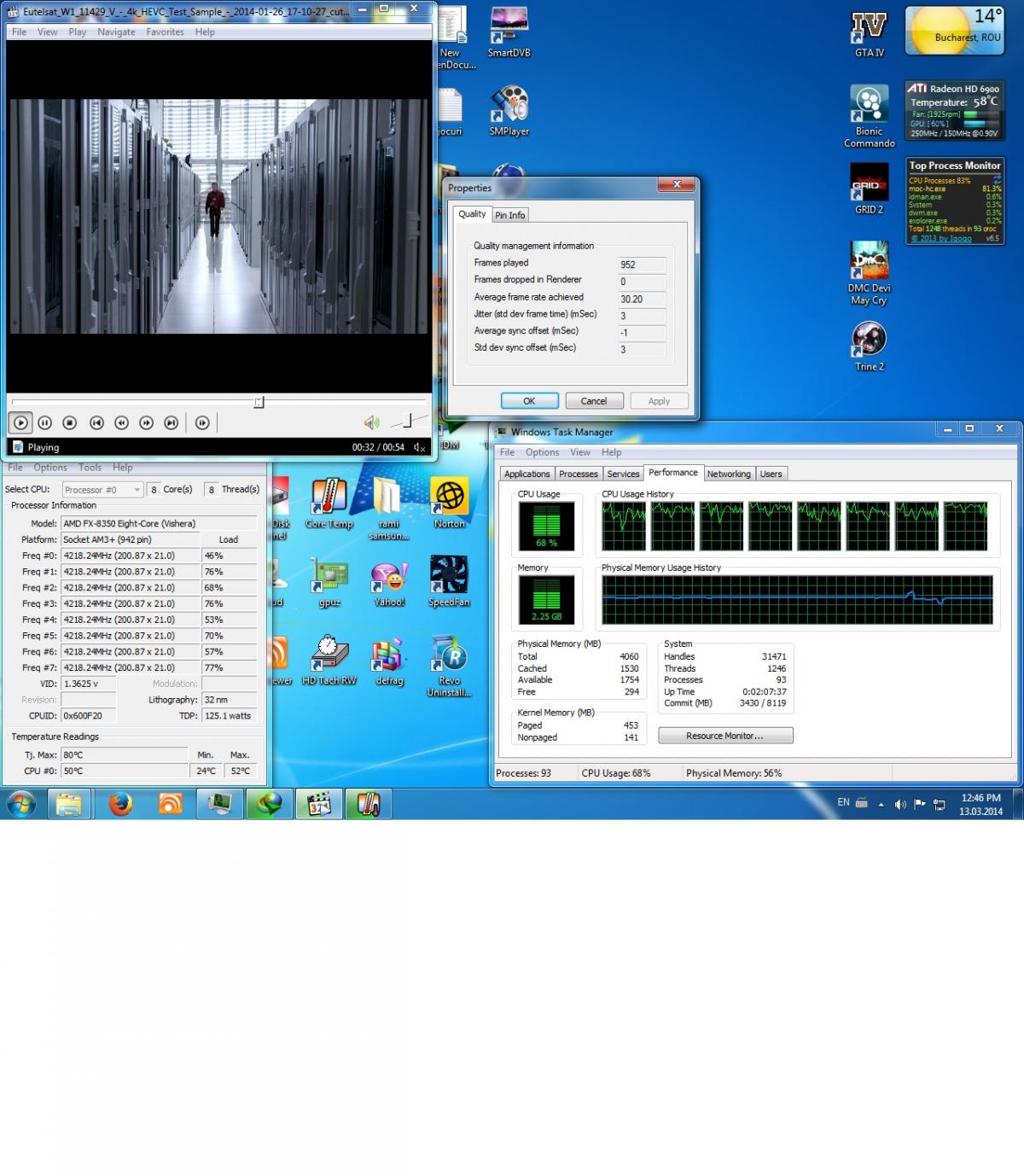

amd fx8350 power:)
Edited by bogdan1980
