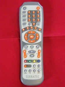

Jumbotron Posted February 9, 2018 Posted February 9, 2018 (edited) On 28/1/2016 at 11:53 PM, rodjd said: This plugin is NOT COMPATIBLE with Please make UPDATE too plugin. Hello everybody, This is my first post here. I have the Terratec Cinergy 2400i DT and the same Remote Control as you. And I'm finding not possible to make this RC work with DVBViewer pro either because the program seems to not detect when I press any button on the RC. Yes, I've installed the plugin and read its readme. And I've activated it in the options of the program. But when I try to map the buttons of my RC in the 'Input' section of the options, I find that task is impossible, because, no matter which button on the RC I press, the program seems to not detect any input from my control. And I've been careful enough to activate 'learn' previously, so that's not the problem. In fact, the program reacts normally if I press any key on my keyboard instead. And finally I don't think it is the receiver of my RC that is faulty, because I can clearly see its activity led reacting normally whenever I press a button on the control. So I'm completely lost. Any ideas would be much welcome. Thank you. Edited February 9, 2018 by Jumbotron Quote
