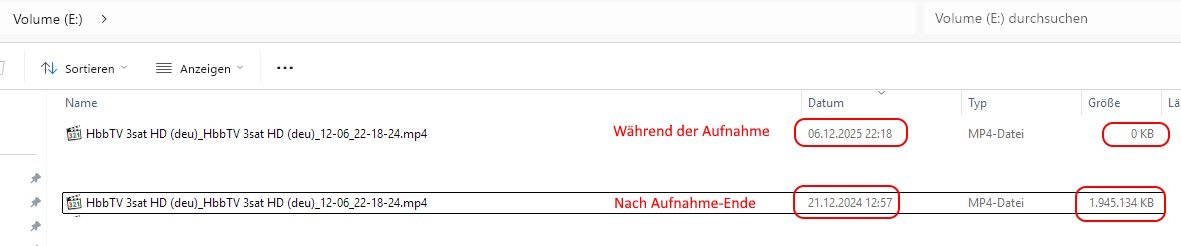

So einfach kommst du aus der Nummer nicht raus. Der DVBViewer übernimmt bei Downloads definitiv kein Datum aus der Mediathek. Und erzeugt auch keinen Datumseintrag für die Datei. Das macht Windows. Zu Beginn des Downloads ein Erstellt-Datum. Und spätestens am Ende des Downloads, wenn der DVBViewer die Datei schließt, ein finales Geändert-Datum. Kann man in den Eigenschaften der Datei sehen. Wenn der Explorer nach Geändert-Datum sortiert, kann es eine Weile dauern, bis er eine Änderung merkt und die Sortierung anpasst.

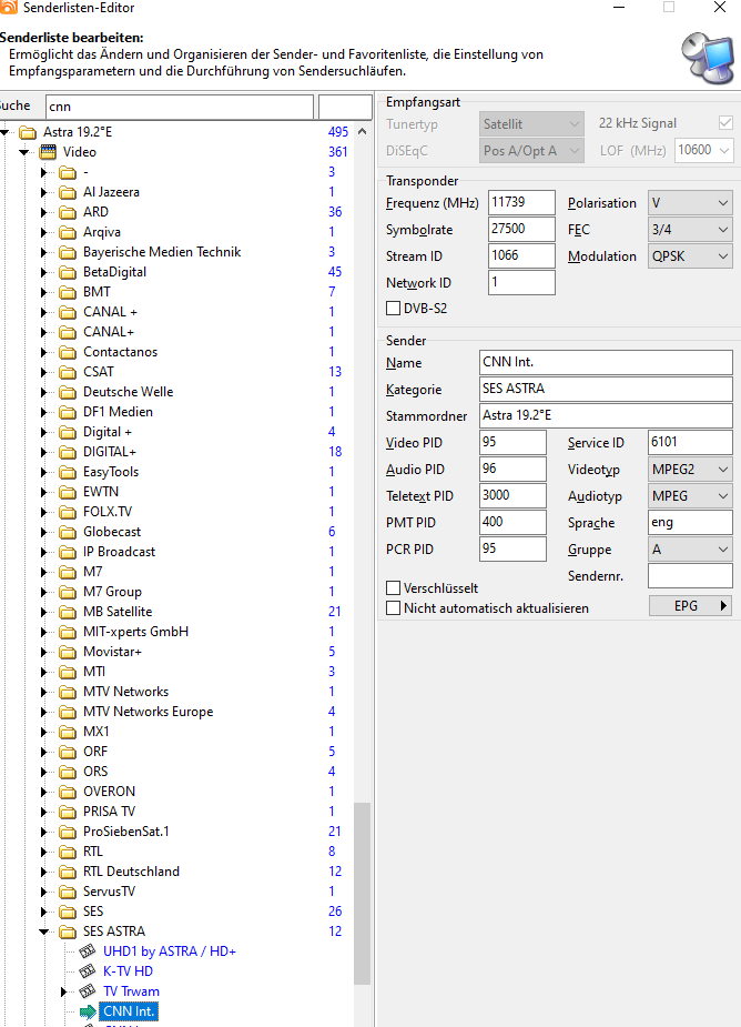

These three channels have one thing in common: They are located in the high band (frequency above 11700 MHz) and the polarisation is vertical. I'd check if other channels with these attributes, but other frequencies are also affected, e.g. MTV on 11973 V or Kabel 1 Austria on 12051 V. You can use the DVBViewer Channel Editor for testing, that displays the frequency and polarisation of the selected channel on its right side. A channel is tuned by double-clicking it. Or even better: Use the scanner and analyzer tool TransEdit for testing. Download it from the members area, store TransEdit.exe in the DVBViewer program directory (where DVBViewer.exe is), select the Astra 19.2° East transponder list on the left side of the main window, a transponder (frequency) on the right side, and click "Scan Selected" for checking if it yields any results. If certain combinations of the attributes low/high band (frequency below/above 11700 MHz) and vertical/horizontal polarisation cannot be received anymore, it may indicate a damaged outdor equipment (LNB) or receiver.
I had it in a category called for 3 years and it worked. Lately I tried SES and English. I don't really think the category makes any difference. What would happen if I installed DVBViewer again without removing the existing one, like being a repair?

Here is my CNN Int.ini CNN Int..ini The only difference is "Category=SES ASTRA" and "FEC=2" I do not know if "Category=English" is your chose for a personal Category. Give it a try. You can control and change your settings even in Channellist-Editor, do not forget to press the "Apply" button.
So, das ist mir jetzt schon ein bisschen peinlich aber, Ich habe jetzt mal in meinem Aufnahmeverzeichnis gescrolled und folgendes festgestellt: Während der Aufnahme ist das Aufnahmedatum das aktuelle Datum und Uhrzeit meines Rechners. Nach Ende der Aufnahme wird das Datum offenbar aus der Mediathek übernommen und ändert sich. Dadurch rutschte die Datei in meinem Explorer weiter nach unten und ich dachte sie existiert nicht. Aber alle herunter geladenen Dateien existierten! Diese Änderung ist mir bisher nur bei 3sat aufgefallen. Alle anderen Aufnahmen haben mein Aufnahmedatum behalten. Im Screenshot ein Beispiel: Heute die Oper Hänsel und Gretel aufgenommen. Oben die Anzeige im Explorer während der Aufnahme und unten nachdem die Aufnahme beendet war. Den Hinweis von Webturtle zu MediathekView http://www.mediathekview.de/ habe ich aufgegrifffen und finde diese Seite sehr hilfreich. Man kommt hier schneller zum gesuchten Beitrag und kann gleich wählen in welcher Qualität die Aufnahme gespeichert werden soll.
Tried it without result.
FEC=3/4 in channel.ini is invalid, there are just "whole numbers" allowed [Channel0] TunerType=1 Root=Astra 19.2°E Category=SES ASTRA FEC=2 Change "FEC=3/4" in channel.ini to "FEC=2" this is the code for the "FEC 3/4" tuning parameter it will be the same with Tele 5 that uses the "FEC 3/4" tuning parameter

Your ini does exactly the same thing. if Istart up with CNN it gives me a black screen. If I switch from another working channel it freezes that channel. Besides CNN I have 1 more channel that does that: A german channel: tele 5. It all started when many german channels chose to only transmit in HD and I had to do a new scan. At the moment every channel works well, except those two. Very strange.
