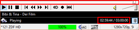

Griga replied to videogamingtown's topic in Bug Reports DVBViewer Pro/GE
I thought so. m3u8 indicates the HLS streaming format (HTTP Live Streaming). It allows broadcasters to provide a timeshift buffer, so applications can jump back in time. This is supported by DVBViewer. Here is an example, showing the German IPTV channel ZDF HD, that provides a timeshift buffer of 3 hours: When playing such a channel, DVBViewer shows the current playback position in the buffer and the buffer lenght in its control bar. While you are dragging the slider to the left or right, the display changes. It shows the actual time of day belonging to the slider position and to "now" (the live edge), so you can jump to a certain time in the past. However, I never had the opportunity to test this functionailty with a timeshift buffer that comprises several days. The maximum I've seen up to now is 8 hours. Maybe DVBViewer is not able to handle it correctly or at all if the size is greater than 24 hours. I even don't know if the "archive" you have mentioned uses this HLS mechanism or something else. This would be something to be elobarated in future DVBViewer versions... - Yesterday
