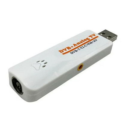

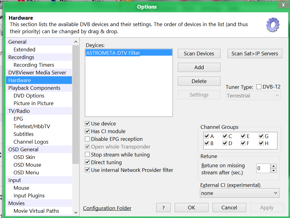

Alyosha2001 posted a topic in DVB Hardware (Digital TV cards)
Hi, I was using an Astrometa DVB with VID_15F4_PID_0131 for years without an issue on DVB-C with DVBViewer, and I wanted one more device for another location. Since I could not find it anywhere on sale anymore, I bought the hybrid one (VID_15F4_PID_0135). My issue with the new one is that I cannont make it switch to DVB-C in DVBViewer. It works in ProgDVB and TVRprog in DVB-C. The old one uses the AstrometaSwitch utility to do that; this one does not. Has anyone else had this and made working on cable in DVBViewer? I attatched a screenshot of how the "Tuner type" is greyed out on "Terrestrial" and also a picture of the tuner. Thanks! -
