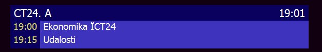

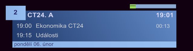

when I'm using czech DVB-T multiplex, DVBViewer GE version has problems with middle europe charset (see screenshot). Wrong characters are present in EPG and Info bar. Teletext charset can be set in Options, so there is no problem. Is it possible to set different charset for GE edition? In PRO version it seems to be everywhere ok.
GE version:
PRO version:

Please try test version 1.8.6 from the members area, beta section. Replace DVBViewer.exe.
I'm not familiar with east european character sets at all, so I just copied some code from DVBViewer Pro. I hope it was the right part. :radscorpion:
Thank you, it helps, now there are no strange characters visible :-)
Only problem is in coding in EPG, some specific czech characters are not displayed correctly, but this is the same like in PRO version. If you want I can make a screenshot with correct spelling, but I guess this problem is more complicated and is concerning of also other eastern languages (Polish, ...). But I can help you with this problem anyway.
