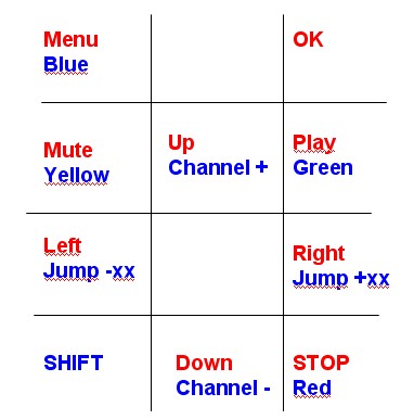

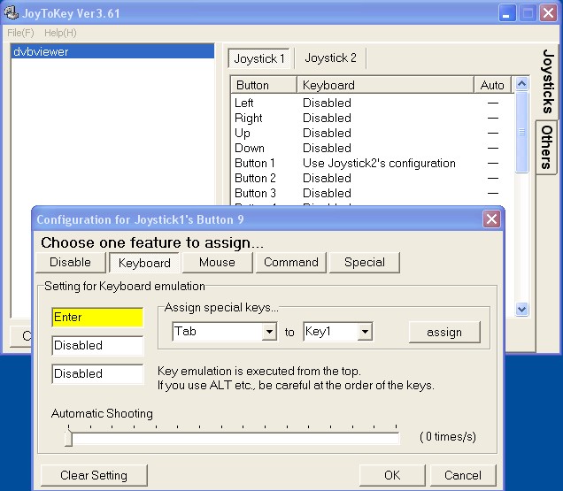

The dance mat just acts as a standard joystick and each pad is mapped to a button. Usually you will find 10 buttons. As DVBViewer does not (yet?) have an input plugin for a joystick I used a very nice freeware utility called joytokey link. This utility converts each button press to a keyboard sequence that is then interpreted as usual by DVBViewer. To have more commands I’m using the ‘triangle’button as a shift button so one can have up to 18 different commands available.
1) Download extract and launch joytokey
2) Verify that your dancemat/joystick is recognized by clicking on the Others tab on the right
3) If everything is OK create a new configuration for DVBViewer
4) Map each button to the correct key sequence for joystick1
5) Define the button that will act as the “shift”for using the configurayion for jostick2
6) Map the buttons for joystick2
7) That’s it!
