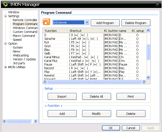

zaphod1 Posted November 15, 2006 Posted November 15, 2006 Hi, I´m very, very new to this so please keep that in mind Is there any plugin for the Imon Pad controller to the DVBViewer? http://www.soundgraph.com/pr/e_pr_12.asp?m1d=1&m2d=12 Or is it simple to configure in some kind of easy way? I would just like to change channels and so on. I've got a 3RSystems HT1100 case, which ships with an IMON Pad remote control and an IMON VFD display. I mapped all default DVBViewer keys to the corresponding IMON Pad keys. You just have to add a few commands manually to your DVBViewer. Just import the attached imo file into your IMON Pad settings menu. DVBViewer.zip Quote
MJo Posted January 7, 2007 Posted January 7, 2007 (edited) I've got a 3RSystems HT1100 case, which ships with an IMON Pad remote control and an IMON VFD display. I mapped all default DVBViewer keys to the corresponding IMON Pad keys. You just have to add a few commands manually to your DVBViewer. Just import the attached imo file into your IMON Pad settings menu. Thanks, that works quite fine! I'm wondering: how you find out Function names concerning DVBViewer? I see that you are calling DVBViewer with arguments/functions/parameters "Rot, Grün, Gelb, Blau" (colours, know that much ) is there some interface available somewhere? Trying to map some buttons more in Soundgraph Imon pad remote controller. Thanks, Edited January 7, 2007 by MJo Quote
zaphod1 Posted January 31, 2007 Posted January 31, 2007 Thanks, that works quite fine! I'm wondering: how you find out Function names concerning DVBViewer? I see that you are calling DVBViewer with arguments/functions/parameters "Rot, Grün, Gelb, Blau" (colours, know that much ) is there some interface available somewhere? Trying to map some buttons more in Soundgraph Imon pad remote controller. Thanks, It's pretty simple to map new keys in the imon pad. Just go to DVBViewer and look into options->input. In here is the list of all available functions. I added new key mappings to that. I.e. "H" for entering the HTP main menu. After assigningg this key in DVBVieewer just open the imon manager and assign a new rc button mapping to the key. That s itt. Quote
MJo Posted February 12, 2007 Posted February 12, 2007 It's pretty simple to map new keys in the imon pad. Just go to DVBViewer and look into options->input. In here is the list of all available functions. I added new key mappings to that. I.e. "H" for entering the HTP main menu. After assigningg this key in DVBVieewer just open the imon manager and assign a new rc button mapping to the key. Thats itt. Allright so first map some function inside DVBViewer to some keyboard button. Then assign rc button to that keyboard button inside Imon manager. Still there is something I don't get it. Zaphod1 has .imo file above. See attachment! It's mapped to "functions" instead of keys for DVBViewer? Funny thing is that those "functions" are Deutch (nothing against Germany ) or then it makes sense that there is only Deutch "function interface" to be used no matter what is the UI language set to DVBViewer (wondering this as a sw developer by myself) or do one really have to change function names when changing UI language for the program? Or is this "function interface" obsolete in whole? I'm lost Quote

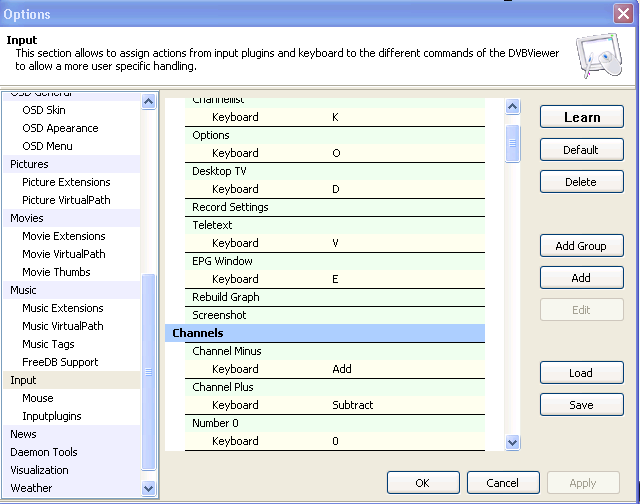

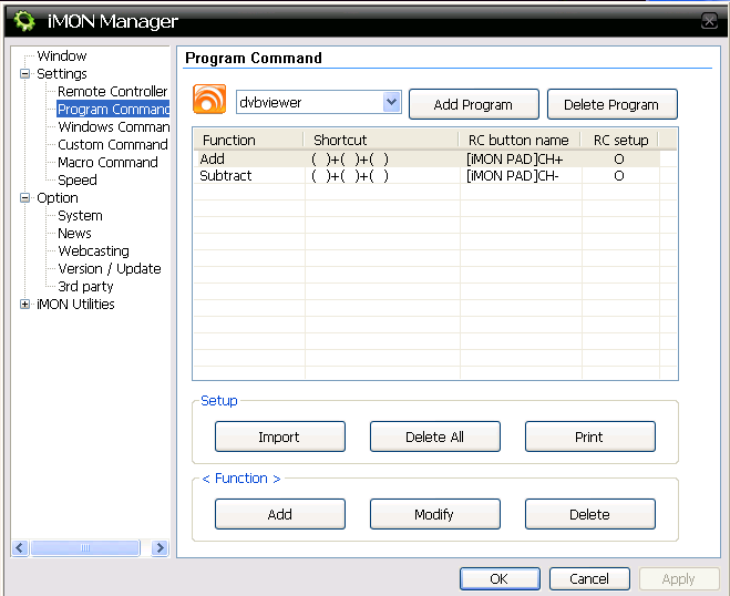

MJo Posted February 12, 2007 Posted February 12, 2007 Ok, starting with the basics: channel changing. As wee see "Channel Minus" function is mapped to keyboard "Add" button. I tried to map this with Imon manager -> no show. Also I tried to use "Channel Minus" instead of "Add" in Imon manager -> no show. (ignore that logic is mixed minus is operated with Add button but that's not important, just don't want to take new screenshots). Imon remote's up and down functionality works with this big major tap button. I guess this is because remote is now handled as keyboard. Quote
Guest Lars_MQ Posted February 12, 2007 Posted February 12, 2007 OK in Imon. 1. Assign a name to the action (example: ch+) 2. then you tell Imon which keyboard key it should send to the application. 3. then you tell imon which key on the remote is assigned to this action. in DVBViewer: If you choose another key than default, you select the action, press learn and press the Remote key and it should be assigned in DVBViewer. Maybe you should simply read the imon manual a little bit. Quote
