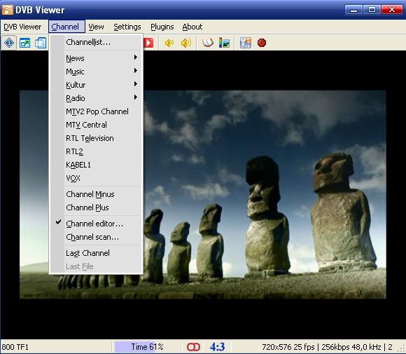

I have installed the latest DVBViewer 3.5 from the member section, on my PVR machine, but I cannot edit the channels.
When I go on the option in the menu, the window loses the focus, but nothing is displayed. The menu is checked :radscorpion: (as you can see on the capture).
I have reformatted the PC, but still the same problem.
I have a SkyStar 2 with 4.4 drivers.
Thanks,
Squizzer.

The problem seems not to be caused by your setup.xml file.
Just tested it with your setup.xml file and the channel editor window appears, after i click on "options" in the channel list.
That's what I think as the option in the menu has a check which is not a normal behaviour.
Well, it seems that something is opening and closing quickly ...
Edited by squizzer22
The checkmark is a normal behaviour! It appears after you open the channel editor.
