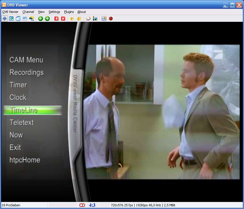

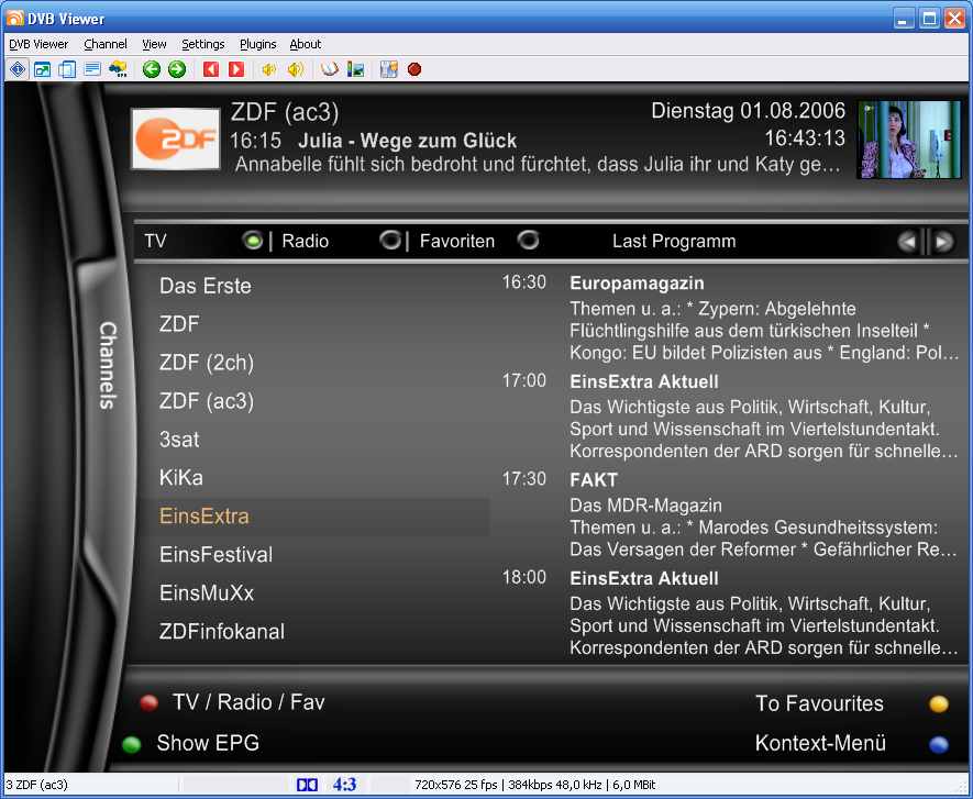

Not really a problem of the DVBViewer, but at least reproduceable. By the way PSP 7 is working fine, only PSP >=9 is acting weird. Honestly i have no real idea why, but since a longer time i avoided to play with psp9 while running the viewer in overlay. Anyhow the new default skin will be much more cooler in vmr mode :bye:

Nice,
when do you think the new osd skin will be released?
mfg Steffen
Edited by steffenvogel
well unluckily when its done :bye: The graphics are done by rago and i just arrange the osd- windows in the way he designed them. I think it might take at least 2 weeks to get through, but i honestly look forward and right now the osd looks a way much cooler than the xbmc skin theme :)))
