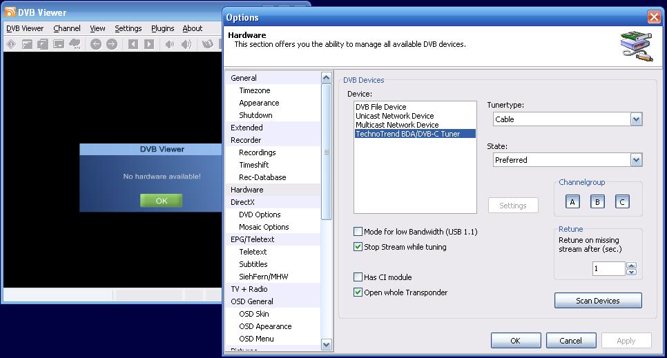

Looks fine to me... (i'm not at my own comp. so i could check). And you can find TT from DVBV Hardware section? And it's selected?
Edited by arc03
Yes, I have it listed in the HW section - See att.
Does this confirm 100% that the DA driver is installed?
Thanks,
Shows just the same with my TT card, so...

I uninstalled, reinstalled and tried every possible combination, but still DVBViewer gives me the "No Hardware Available" error on startup.

Hi NeDrY,
Thanks for th reply - here is what I have done:
- Clean Windows Install
- Windows Media Center 2005 with all latest roll ups and patches
- Latest BDA drives as you mentioned ((4.4.10.17)
- NO the MCE-Tools or TT-Media Center! (Drivers only)
- Technotrend Tuner- and the Capture-Module listed in Device Manager (with right driver version)
- Start DVBViewer (Get error - no hardware available)
- Options -> Hardware and make sure the Card is there (listed at the bottom - no scan required
- Uncheck all Options for the Card
- Exit DVBViewer, Restart PC...
Start up DVBViewer and the error sit still there - "No hardware available" :):disgust::(
I have NTL Cable in the UK, with STB and cale modem connected to the same coax - as soon as I connect the coax to the card to scan, my internet connection from modem drops out and the picture from the STB becomes broken up - seems like when I connect the card to the coax, noise goes wild - no cannels found when scanning.
Is this normal? :wacko:
