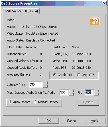

After having tuned such a station, please open the property page of the DVBViewer Filter (View -> Filters -> DVBSource) and check what it reports, particularly the audio state and audio format. Post it here or attach a screenshot.

However, I had a look to see what audio codecs are available in DVBViewer. The audio was using a codec called 'MPA Decoder Filter'. This was the first in the drop down list which is why it was used. Using this codec most radio stations play 'live', but some (r5 live, r5live sports, bbc world service and oneworld) don't. With the codec changed to 'MPEG Audio Decoder' the sound is stuttered like an old fashioned medium wave at night but at a faster speed, while on Descaler Audio Decoder, or Arcsoft MPEG Audio Decoder all the radio stations playOK.
Later - I've found a 'TV/Radio Preformat Detection' option. When the audio is checked those 4 radio stations now play ok on all codecs.
For info attached are 2 screenshots from when using the 'MPA Decoder filter', before checking the 'Radio preformat detection'.

Screenshots which didn't appear in the last post.
'For info attached are 2 screenshots from when using the 'MPA Decoder filter', before checking the 'Radio preformat detection'.

I see - your first experience with DirectShow pitfalls :bye: a few audio decoders need a little help from DVBViewer. However, the MPA decoder should have played the 48 khz 192 kbps stream, because that's as normal as can be. :)
