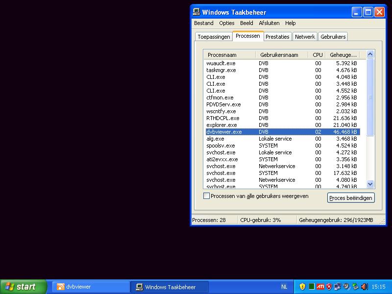

More info can be found in previous messages but this is the latest situation.
WDM drivers: encrypted channels can be opened but bad video performance both with onboard I945GM as with ATI 1600Pro. FTA has the same problem.
So, latest BDA drivers and FTA works great but DVBViewer can not tune to any encrypted channel at all.
OSD shows the yellow lock symbol and note: DVBViewer still uses 1-3% processorload so it's doing something but there seems to be a memory problem cause DVBviwer keeps on using more and more memory up to 47500KB starting from around 36700KB.
Mediaportal has no problems with the cam and shows the encrypted channels, but it's TV engine is not so good. Point is: that confirms that the problem is related with DVBViewer.
Signal strengts varies between 46% and 73%
Quality strengts between 53% and 99%

Succeeded:
support.zip and jpeg of task manager showing ram use
Since it is a cam problem:
Cam menu was accessible, cam info also, smartcard info failed.
Additional info: debug log:
