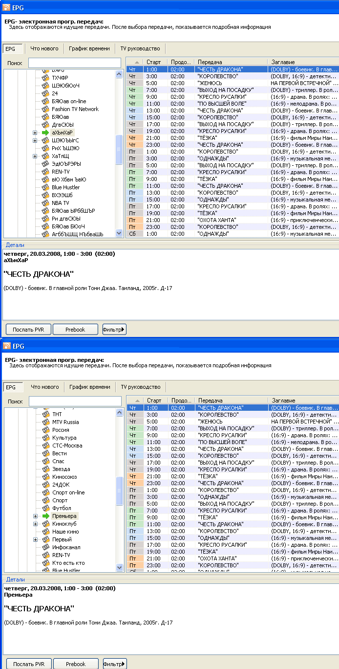

Valts Posted March 16, 2008 Posted March 16, 2008 (edited) Hmm this should work - especially for bulgarian and russian epg. Can you post your epg.dat and channel.dat? A dump of the transponder would be also usefull. All i can say is that the test dump i used is displaying the content in the way it should be displayed. Christian In my case it displays some parts correctly... Not sure how to make dump of the transponder. channels_epg.zip Edited March 16, 2008 by Valts Quote
hackbart Posted March 16, 2008 Posted March 16, 2008 Okay, what you did not mentioned is that the richttext field shows the correct information Yes i think the problem itself can be solved by us (its the treeview which ignores the charset). Christian Quote
zapimir Posted March 20, 2008 Posted March 20, 2008 Problem not in treeview, problem in trasponder scanning. After renaming in treeview channels name showed correctly. Channels.dat and epg.dat http://zapimir.net/temp/DVBViewer.zip In fixed dir channels.dat after renaming How to create a dump of the transponder? Quote
hackbart Posted March 20, 2008 Posted March 20, 2008 The problem with the channel names is that you dont gather the information of the language for the name. In the EPG you get at least the hint which language is used for the text. In this way we are able to convert the content into the proper texts. Christian Quote

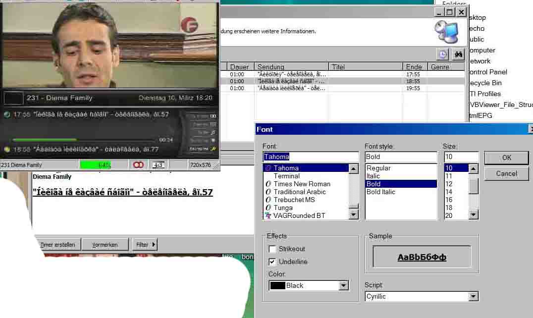

dbotev Posted March 9, 2009 Posted March 9, 2009 Hi, I bought DVBViewer 4.0.0.0. My Operating System: Vista Ultimate SP1 English version. Even in this version the problem with the Cyrillic charsets still exists. I use DVBViewer for receiving of Bulgarian channels at Hellas SAT 39.0 (Bulsatcom). The Cyrillic EPG data is unreadable. The “Now playing”- Information after channel switch is also unreadable for the Bulgarian channels. I have tried to change font settings and encoding, I changed the “Input Locale”-Setting in the Regional and Language Options to bulgarian, but I still have the same Problems! Only after export of the EPG Data in html format everything is showed correctly in the web browser. Does anyone have experience with Vista and Cyrillic char sets? Please help! Quote

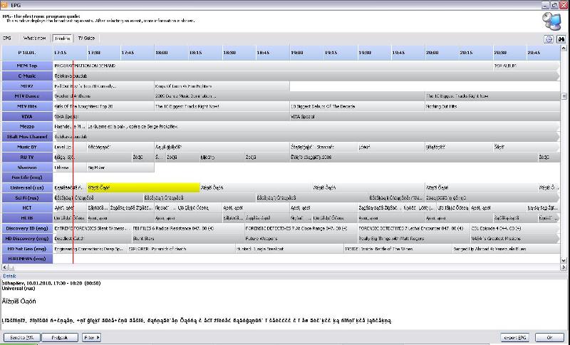

kreisi Posted January 10, 2010 Posted January 10, 2010 I have a problem with Cyrillic EPG. did not find the answer to that would help me. DVBViewer Version: V4.2.1 Quote
kreisi Posted January 10, 2010 Posted January 10, 2010 (edited) I have a problem with Cyrillic EPG. did not find the answer to that would help me. DVBViewer Version: V4.2.1 DVB-C STV Tallinn Edited January 10, 2010 by kreisi Quote

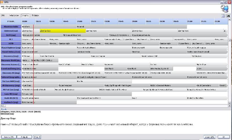

Tjod Posted January 10, 2010 Posted January 10, 2010 Should be Ok in the current Beta: http://www.DVBViewer.info/forum/index.php?showtopic=36446 Quote

IRa Posted January 10, 2010 Posted January 10, 2010 but the beta version does not display subtitles. txt, and the choice of DVB subtitles but they do not appear.No problem here to see DVB or teletext subtitles with latest beta. Quote
