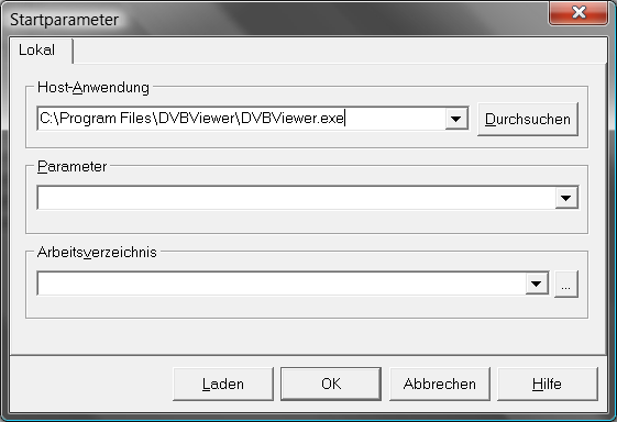

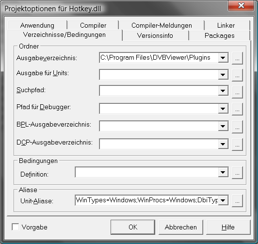

Should it be possible to run/test plugins in Delphi or must they always be loaded
by DVBViewer application ?
Edited by Bobben
They should be loaded by DVBViewer. But you can do it inside Delphi.
define the output path and the host application.
Then, if you click "run", DVBViewer will be startet with the new Plugin and the plugin is running inside Delphis debugger.
