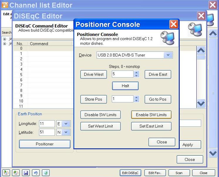

Hello DVBViewer-fans,
I tested new version of DVBViewer (3.8) and I find it very well done.
But one feature, I still miss in the DVBViewer: steering the antenne with
a Diseqc 1.2-compatible motor. I use BDA-driver from Technotrend with
USB-conncted Hardware (S-2400). I found the dialog for driving the antenne,
but non of the buttons make the motor move. See the attached picture.
Has somebody tried to move an antenne with motor using BDA-driver from
Technotrend?
Thank's in advance
Chris
Technotrend?
Thank's in advance
Chris
Hey Chris!
I'Ve got TT-Connect S-2400 too. But as far as I know, it does not support Diseqc 1.2 only 1.0.
Sadly I only got a Diseqc 1.2 Motor thus I have not been able to move the Motor with S-2400.
Please correct me if I'm wrong.
