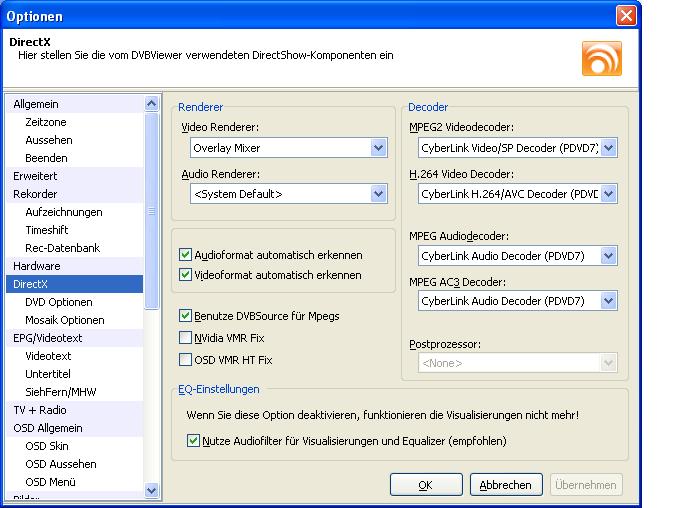

1. Use detect videoformat and disable fast channelchange in the options.

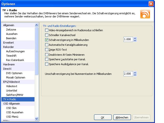

first: i've already checked "detect video format" (Videoformat automatisch erkennen) and disabled the fast channel changes.

There is an easy workaround for the issue:
Just change the "Channel +" and "Channel -" settings in "Eingabe" with "Stop graph" before. You have to use the "Lernen" feature and to assign a new command.
The result is perfect, but channel switching is >3 seconds in FTA-channels and >6 seconds in encrypted channels.
With more than one card the issue can be solved by the programmers, just the behaviour of "Bevorzugt" has to be used again after switching back to a FTA-channel.
Unfortunately Lars don't like this feature (it is just 100% what the function describes) when switching from encryption to FTA due to the longer switching time (around 4 seconds).
Maybe you find a better workaround or Lars can at least change the "Bevorzugt" behaviour for users with more than one card :bye: .
