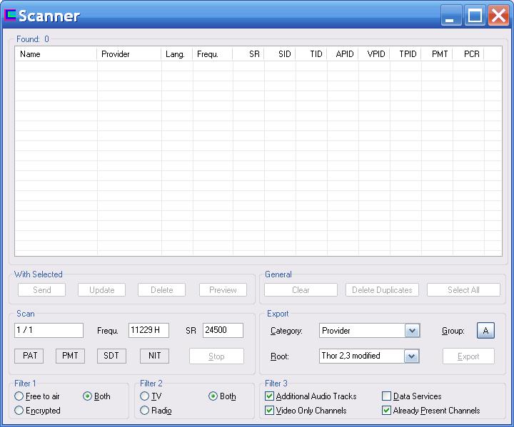

Thanks, but.. Could someone please tell me why this (Thor) transponderlist does not find all my channels?
On some transponders it finds the expected channels, but on others nothing. ex. 11229 that according to LyngSat should carry Discovery Channel, Animal Planet etc. The fields PAT, PMT, SDT are all gray :thumbsup:
Please see attached screendump.

Thanks for you fast reply! But...
Besides my FireDTV (that shows the problem) I also have a ´ordinary´ receiver from Canal Digital (CDC-7000 ST) and it displays all channels just fine. I´m swapping the decodercard from one device to the other, so it must be good too.
Also notice that the FireDTV been receiving all channels just fine until some weeks ago. It seems some of the transponders / channels changed at that point, and afterwards I haven´t been able to find half of the channels.... Could it be my FireDTV thats gone bad? Only strange that it still receives half the channels??!
