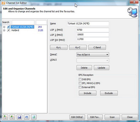

TurkSAT is on port 1 which is Pos A/OptA

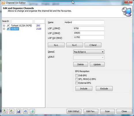

Hotbird is on port 2 which is Pos B/OptA

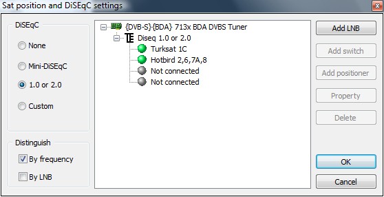

can you read the diseqc settings from progdvb? Is it identical?
Well, here are the screenshots. I hope it's my mistake ;)
..dunno, maybe diseqc for your card isn't supported by the DVBViewer or it's a vista-problem. Strange that it's working with progdvb. ;)
Unfortunately DVBViewer doesn't know which method for sending DiSEqC commands to the FlyDVB-Trio resp. its driver must be applied. However, the device seems to be based on a known design. Medion hybrid cards (and others with Philips chipset) also identify themselves as "713x BDA DVBS Tuner". So we can try something:
