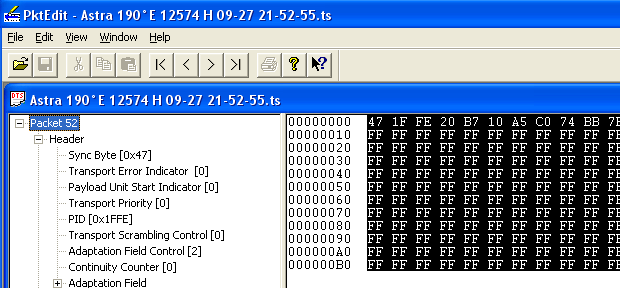

Derrick Posted September 27, 2007 Posted September 27, 2007 The problem seems to be the PCR_TS_packets. The scrambling flag is set to 1. This stream is not recorded in the Pro, though the adaptation field that contains the pcr is by definition not scrambled. As a result the TS_recording is incomplete as well. The GE records the "scrambled" pcr correctly Quote
Griga Posted September 27, 2007 Posted September 27, 2007 The problem seems to be the PCR_TS_packets. The scrambling flag is set to 1. I can't see it in the PCR stream with PID 8190 on Astra 19°E 12574 H. That's the one BVN uses. The TS header is 47 1F FE 20. Please explain more detailed. The GE records the "scrambled" pcr as well Recording BVN as MPG is working here with DVBViewer Pro 3.8.1.1 and 3.8.0.0. DVBViewer GE definitely kicks all scrambled packets when recording. Explanation? Quote

Derrick Posted September 27, 2007 Posted September 27, 2007 I can't see it in the PCR stream with PID 8190 on Astra 19°E 12574 H. That's the one BVN uses. The TS header is 47 1F FE 20. Please explain more detailed.Recording BVN as MPG is working here with DVBViewer Pro 3.8.1.1 and 3.8.0.0. DVBViewer GE definitely kicks all scrambled packets when recording. Explanation? Please check again and have a look with transedit.. @Lars, it has nothing to do with plugins. The analysis is from a transponder dump with transedit Quote
Griga Posted September 27, 2007 Posted September 27, 2007 Please check again and have a look with transedit.. That's exactly what I did, and I did it again: Quote

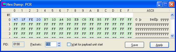

Griga Posted September 27, 2007 Posted September 27, 2007 Another screenshot, just as comparison - BVN (all PIDs) recorded with TransEdit: Quote
Derrick Posted September 27, 2007 Posted September 27, 2007 IMHO I've described the problem correctly but now I know why only I (and probably @erikap) see the scrambled pcr. The culprit is this CI module. It changes the scrambling flag of the pcr_packets. That's why I see a scrambled 0x1ffe_stream in transedit. When pulling the module everything is ok. I did the test with the firedtv. When I'd taken the pinnacle or the ss2 instead, we would never have discovered this (module)bug Quote
