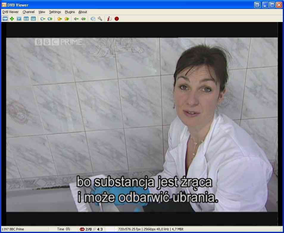

hackbart Posted October 3, 2007 Posted October 3, 2007 Tested with BBC Prime and it works fine - okay since i can not watch the transmission i just compared the polish teletext with the closed caption display. It is synchroneous. I also tested some older recordings from finland and denmark and it is also running like it should. Are you sure that the transmission did not not changed instead, because we did not changed the code for the subtitles. Christian Quote

jaska915 Posted October 3, 2007 Posted October 3, 2007 (edited) Tested with few channels with DVB-subtitles and everyone seems to behave the same. First I get couple lines of subtitles that are too early, then few lines that just flash on the screen for about tenth of a second. Next few lines then stay on screen ~normal time but are too early/late. And so on. Same thing happens with recorded program with DVB-subtitling, just tested. I also tested if switching back to 2.8.5 filter would help, but no. Strange thing, but same problem occurred with 3.8.x.x betas also. edit: don't know about transmission changes, but with 3.8 things work as it should;) Also removed 3.9 and reinstalled 3.8 just to verify. edit2: and I can assure that I will provide any information and help that I possibly can. Edited October 3, 2007 by jaska915 Quote

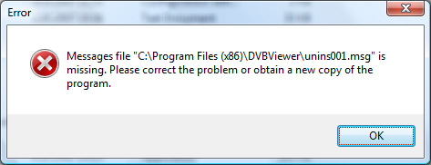

IRa Posted October 3, 2007 Posted October 3, 2007 Unfortenately I can confirm that problem with DVB subtitles. Maybe that was a transmission problem, now I can not reproduse same major problem anymore. (however they comes a little bit too earlier) Some other things conserning the installer, I get following message and if I select in the wizzard that I edit existing settings it will not offer earlier folder for recordings but gives windows "my videos" folder instead (timeshift folder comes alright) Quote
