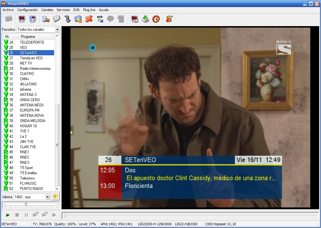

supertack Posted November 10, 2007 Posted November 10, 2007 (edited) Well, I'll try to explain as I speak and understand spanish. In fact, all the spanish DVB-T channels are now transmitted by DVB-S (FTA) using the Hispasat 30°W satellite. However, it is not a standard DVB-S transmission, as the scan of the frequencies doesn't report any channel. The frequencies used in DVB-S transmission are : 11570 H 11655 H 12622 H 12622 V 12640 H 12640 V All with SR 12960 and FEC 5/6 I tried to scan those frequencies with both DVBViewer Pro and TransEdit with no result. After doing some researches on the spanish web, I found that the last version of HispaDVB (working with BDA devices too) can receive those channels, with activating an option known as "Retevision TX" as you can see in this snapshot I've made on my own PC : You can see at the right corner that channels were found successfully. Well, we hope that we can have this soon on DVBViewer Pro Edited November 11, 2007 by supertack

supertack Posted November 11, 2007 Posted November 11, 2007 (edited) Well, I tried to record or export with TransEdit Analyzer with no success. However, here you have a complete snapshot of one of the transponders we are speaking about. Feel free to ask me for more information if needed. I've joined the HispaDVB2 channel list in order to help you guessing right PIDs from my snapshot. All the channels included in this list are "Retevision" ones. You can also see here a snapshot of "40 Latino" channel properties . This channel is included in the same transponder I've analyzed with TransEdit. LstCanales.ini Edited November 11, 2007 by supertack
