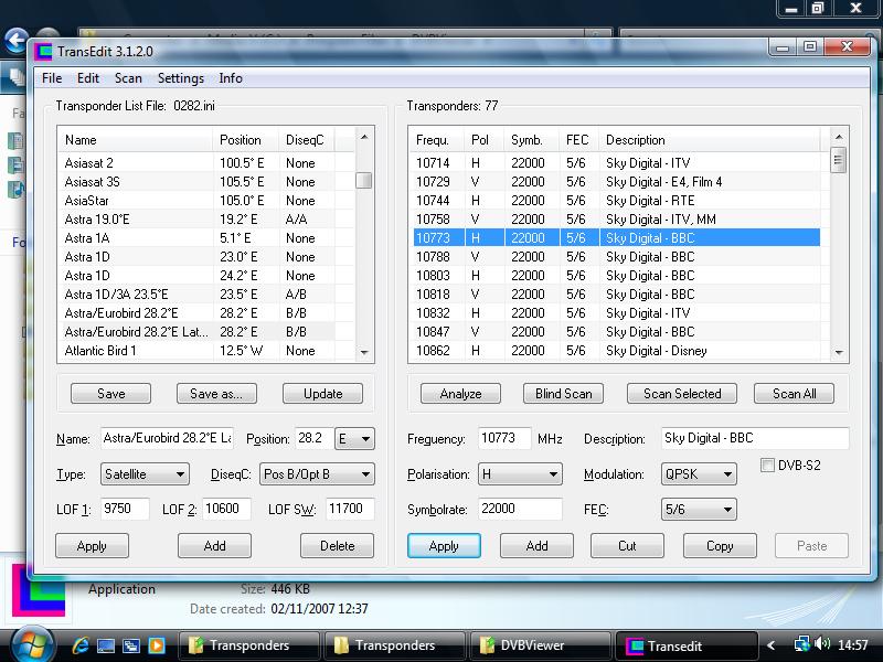

ricabullah Posted November 17, 2007 Posted November 17, 2007 (edited) Is this what you need? Yes, Now you know the address of Transponders folder(under CMUV) /maybe you know already where it is/ If you don't mind lets try another thing? Close program. Find out and carry this Transponders folder on to the desktop. Open Transedit and give us another screenshot. Edited November 17, 2007 by ricabullah Quote
Kevin Bishop Posted November 17, 2007 Author Posted November 17, 2007 I hope this is what you need.... The transponder list I am using is one I compiled myself, with all the Sky Digital transponders: 282.ini Channel scan finds the frequency 12168-V, scans it and finds all the channels, they just don't work ?!? I did get Channel 4 working last week, but after the recent re-scan, I cannot get it working at all. Quote
ricabullah Posted November 17, 2007 Posted November 17, 2007 I hope this is what you need.... The transponder list I am using is one I compiled myself, with all the Sky Digital transponders: 282.ini Channel scan finds the frequency 12168-V, scans it and finds all the channels, they just don't work ?!? I did get Channel 4 working last week, but after the recent re-scan, I cannot get it working at all. Did you really carry Transponders folder under CMUV onto desktop before opening Transedit? Quote
Kevin Bishop Posted November 17, 2007 Author Posted November 17, 2007 Yes, but don't I need to tell transedit to use that folder? I don;t know where transedit defaults to. If it saves any time: I am technically an expert when it comes to PCs (I'm a computer & network consultant of some 20 years), but I am fairly new to Vista and DVBViewer. So please don't hesitate to ask technical questions ;-) Quote
ricabullah Posted November 17, 2007 Posted November 17, 2007 (edited) OK, Kevin then you already know what folder Transedit uses. (normally it uses Transponders folder under CMUV) I clean that folder first and download needed inis from Kingofsat into that folder. Channel scan finds the frequency 12168-V, scans it and finds all the channels, they just don't work ?!? Have you analized 12168 V recently by Transedit analiser? The level of signal, etc? Edited November 17, 2007 by ricabullah Quote
