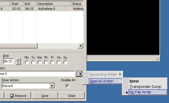

Hello,
Is depending on the not recording and only tuning or is another problem?
yes, then a tuning timer has no end time.
You must use a normal timer entry with the special action "No File Write".
Now it is a normal timer with end action without writing data in a file.
