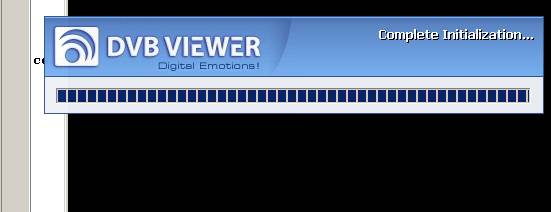

Russel-Athletic Posted September 15, 2003 Posted September 15, 2003 3. Splashscreen while startup (which is giving more informations, what the dvbiewer is doing) i'm really looking forward for this feature Do you really see some Informations what the DVBViewer is doing or just, that it will load? I think it will be interressting if you see really what he does. I love it if a programm say "load 3ksg35.dll" and i don't know what it ist. It seems to bee more serious
Guest Oliver Posted September 15, 2003 Posted September 15, 2003 Do you really see some Informations what the DVBViewer is doing Yes, all parts being loaded are shown. Bye, Oliver
Griga Posted September 15, 2003 Posted September 15, 2003 Yes, all parts being loaded are shown. ...but the messages come very fast - slomo needed for reading it all. If you previously thought that the DBViewer loads quite slowly, you now get the impression that it's terribly fast - nice trick What I love most: The way the splash screen slowly fades when the main window finally appears. That's really great! Griga
Griga Posted September 15, 2003 Posted September 15, 2003 Hmm, something new again... to encourage demoralised users, Christian decided to let the DVBViewer display not only error messages, but also success messages. Quite innovative... but I'm not really sure wether... well, have a look at the attached picture and let us know what you think about it. Griga
Gioxy Posted September 16, 2003 Posted September 16, 2003 Terribly great! Gioxy p.s.: do you remember when the little old Mac II said: Out of memory... eat more fish! Bibliography: ; ; ...
Guest hackbart Posted September 16, 2003 Posted September 16, 2003 yep, this is grigas idea - maybe i should do something like this . I also override ordinary errors like division by 0 etc. made by a fault filter or by the program itself. These errors where not displayed (since in 90% of all cases the user is unable to solve this on his own). So serious and non serious errors are now stored at c:\DVBViewer.log Those Directshow based errors (~115 at the moment) are shown with a small description. I hope to find more detailed stuff to present solutions for them... These are the following messages (maybe somebody is interested to write a small solution for each of them 0x80040207; No common media type between these pins. 0x80040200; Specified media type is invalid. 0x80040201; Specified media subtype is invalid. 0x80040202; This object can only be created as an aggregated object. 0x80040203; The state of the enumerated object has changed and is now inconsistent with the state of the enumerator. Discard any data obtained from previous calls to the enumerator and then update the enumerator by calling the enumerator's Reset method. 0x80040204; At least one of the pins involved in the operation is already connected. 0x80040205; Operation cannot be performed because the filter is active. 0x80040206; One of the specified pins does not support media types. 0x80040208; Two pins of the same direction cannot be connected. 0x80040209; Operation cannot be performed because the pins are not connected. 0x8004020A; No sample buffer allocator is available. 0x8004020B; A run-time error occurred. 0x8004020C; No buffer space has been set. 0x8004020D; The buffer is not big enough. 0x8004020E; An invalid alignment was specified. 0x8004020F; Cannot change allocated memory while the filter is active. 0x80040210; One or more buffers are still active. 0x80040211; Cannot allocate a sample when the allocator is not active. 0x80040212; Cannot allocate memory because no size has been set. 0x80040213; Cannot lock for synchronization because no clock has been defined. 0x80040214; Quality messages could not be sent because no quality sink has been defined. 0x80040215; A required interface has not been implemented. 0x80040216; An object or name was not found. 0x80040217; No combination of intermediate filters could be found to make the connection. 0x80040218; No combination of filters could be found to render the stream. 0x80040219; Could not change formats dynamically. 0x8004021A; No color key has been set. 0x8004021B; Current pin connection is not using the IOverlay transport. 0x8004021C; Current pin connection is not using the IMemInputPin transport. 0x8004021D; Setting a color key would conflict with the palette already set. 0x8004021E; Setting a palette would conflict with the color key already set. 0x8004021F; No matching color key is available. 0x80040220; No palette is available. 0x80040221; Display does not use a palette. 0x80040222; Too many colors for the current display settings. 0x80040223; The state changed while waiting to process the sample. 0x80040224; The operation could not be performed because the filter is not stopped. 0x80040225; The operation could not be performed because the filter is not paused. 0x80040226; The operation could not be performed because the filter is not running. 0x80040227; The operation could not be performed because the filter is in the wrong state. 0x80040228; The sample start time is after the sample end time. 0x80040229; The supplied rectangle is invalid. 0x8004022A; This pin cannot use the supplied media type. 0x8004022B; This sample cannot be rendered. 0x8004022C; This sample cannot be rendered because the end of the stream has been reached. 0x8004022D; An attempt to add a filter with a duplicate name failed. 0x0004022D; An attempt to add a filter with a duplicate name succeeded with a modified name. 0x8004022E; A time-out has expired. 0x8004022F; The file format is invalid. 0x80040230; The list has already been exhausted. 0x80040231; The filter graph is circular. 0x80040232; Updates are not allowed in this state. 0x80040233; An attempt was made to queue a command for a time in the past. 0x80040234; The queued command was already canceled. 0x80040235; Cannot render the file because it is corrupt. 0x80040236; An IOverlay advise link already exists. 0x00040237; The state transition is not complete. 0x80040238; No full-screen modes are available. 0x80040239; This advise cannot be canceled because it was not successfully set. 0x8004023A; Full-screen mode is not available. 0x8004023B; Cannot call IVideoWindow methods while in full-screen mode. 0x80040240; The media type of this file is not recognized. 0x80040241; The source filter for this file could not be loaded. 0x00040242; Some of the streams in this movie are in an unsupported format. 0x80040243; A file appeared to be incomplete. 0x80040244; The file's version number is invalid. 0x00040245; The file contained some property settings that were not used. 0x00040246; Some connections failed and were deferred. 0x80040247; This file is corrupt: it contains an invalid class identifier. 0x80040248; This file is corrupt: it contains an invalid media type. 0x80040249; No time stamp has been set for this sample. 0x00040250; The resource specified is no longer needed. 0x80040251; No media time was set for this sample. 0x80040252; No media time format was selected. 0x80040253; Cannot change balance because audio device is monoaural only. 0x00040254; Could not connect with the media type in the persistent graph. 0x80040255; Cannot play back the video stream: could not find a suitable decompressor. 0x80040256; Cannot play back the audio stream: no audio hardware is available, or the hardware is not supported. 0x00040257; Cannot play back the video stream: could not find a suitable renderer. 0x00040258; Cannot play back the audio stream: could not find a suitable renderer. 0x80040259; Cannot play back the video stream: format "RPZA" is not supported. 0x0004025A; Cannot play back the video stream: format "RPZA" is not supported. 0x8004025B; DirectShow cannot play MPEG movies on this processor. 0x8004025C; Cannot play back the audio stream: the audio format is not supported. 0x8004025D; Cannot play back the video stream: the video format is not supported. 0x8004025E; DirectShow cannot play this video stream because it falls outside the constrained standard. 0x8004025F; Cannot perform the requested function on an object that is not in the filter graph. 0x00040260; The value returned had to be estimated. Its accuracy can't be guaranteed. 0x80040261; Cannot access the time format on an object. 0x80040262; Could not make the connection because the stream is read-only and the filter alters the data. 0x00040263; This success code is reserved for internal purposes within DirectShow. 0x80040264; The buffer is not full enough. 0x80040265; Cannot play back the file: the format is not supported. 0x80040266; Pins cannot connect because they don't support the same transport. 0x00040267; The stream was turned off. 0x00040268; The filter is active, but cannot deliver data. See IMediaFilter::GetState in your SDK. 0x80040269; The Video CD can't be read correctly by the device or the data is corrupt. 0x80040270; The sample had a start time but not a stop time. In this case, the stop time that is returned is set to the start time plus one. 0x80040271; There is not enough video memory at this display resolution and number of colors. Reducing resolution might help. 0x80040272; The video port connection negotiation process has failed. 0x80040273; Either Microsoft® DirectDraw® has not been installed or the video card capabilities are not suitable. Make sure the display is not in 16-color mode. 0x80040274; No video port hardware is available, or the hardware is not responding. 0x80040275; No capture hardware is available, or the hardware is not responding. 0x80040276; This user operation is inhibited by DVD content at this time. 0x80040277; This operation is not permitted in the current domain. 0x80040278; Requested button is not available. 0x80040279; DVD-Video playback graph has not been built yet. 0x8004027A; DVD-Video playback graph building failed. 0x8004027B; DVD-Video playback graph could not be built due to insufficient decoders. 0x8004028B; The DVD Navigator is not in karaoke mode. 0x8004028E; Frame stepping is not supported. 0x80040293; Pin is already blocked on the calling thread. 0x80040294; Pin is already blocked on another thread. 0x80040295; Use of this filter is restricted by a software key. The application must unlock the filter. 0x800403F2; A registry entry is corrupt. 0x91000101; B2C2 Filter error. This is probably caused by wrong tuner settings and/or the trial to tune an encrypted channel.
