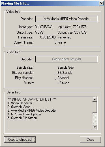

After installation DVBViewer Pro V3.9.1.1 I have problem with recorded film. It has no sound.

DVBSource for Mpeg-Files is enabled. DVBViewer Pro V3.9.1.1 plays with no sound.
GOM Player shows no sound in file.
*** DIRECTSHOW FILTER LIST ***

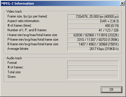

VirtualDub-MPEG2 shows no sound in the file.
Recording as *.ts works fine. When I switch back to Video/Audio PS (*.mpg) still no sound in the recorded file.
