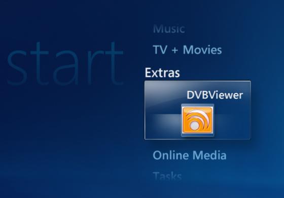

I don't know if my usage patterns are widely different from everyone else, but I'll confess that I use Vista Media Center for the vast majority of my DVB-S/DivX/Xvid viewing, with DVBViewer used solely for DVB-S duties (and particularly for BBC HD, here in the UK). So, I have Vista Media Center running by default, with everything controlled from the remote. Until recently, I had been resorting to the keyboard to launch DVBViewer, but then decided to have a little fiddle with getting DVBViewer registered with the Vista Media Center start menu. Attached is something (very) simple that does this, based on Aaron Stebner's article here:
dvbviewer_vista_mc.zip
By unpacking the .zip somewhere permanent, for example in a folder of the DVBViewer installation, and then (with Administrator priveleges) running "register.bat" followed by "regedit.exe /s DVBViewer.reg", you'll get the following in your Vista Media Center start menu.
You can launch DVBViewer from the menu, Vista Media Center minimizes and DVBViewer starts. When you're finished with DVBViewer, you can just exit as normal and "Green Button" launch back to Vista Media Center. Obviously there's nothing revolutionary/clever in all of this, as it's almost a glorified batch file :) , but I hadn't seen anything mentioned specifically to do this, and I've found it quite handy.
NOTE: A default installation of DVBViewer is assumed at "C:\Program Files\DVBViewer", you'll need to edit "DVBViewer.xml" after unpacking the .zip to specify a different location (prior to running "register.bat") if your installation is elsewhere.
