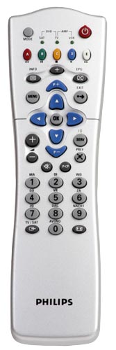

IMO the easiest (and perhaps the best) way to control DVBViewer is with WinLIRC + a serial IR Animax receiver: with these you can fully use almost every remote you have at home (...even those for air conditioners :bye:...)
In this way I use this remote (~12€), with full satisfaction:
