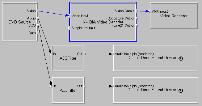

daffy Posted November 1, 2004 Posted November 1, 2004 Sounds good - and nvidia.grf is ready for action once the beta refresh has been released. One thing that irritates me is AC3 support: What if I want to use different graphs based on whether an AC3 or a "plain" audio signal is available? Theoretically, it should be required to set up TWO graphs, one for plain old TV and one for TV with AC3? (Case in point: ZDF + AC3 vs ARD)? What happens if I choose a "plain" audio graph for an AC3 channel? Yes, I could create "nvidia.grf" and "nvidia+ac3.grf" and switch channels AND graphs - but graph switching could be automated? Quote
Griga Posted November 2, 2004 Author Posted November 2, 2004 once the beta refresh has been released Hasn't it yet? Should already be available. Ignore the date. What if I want to use different graphs based on whether an AC3 or a "plain" audio signal is available? Build the graph as shown below I must confess I'm a bit surprised that it works. But it does - switching from Pro7 to Pro7 AC3 and back - no problem. Even the DVBViewer is clever enough to choose the right branch for inserting the audio sample dumper. The source filter knows to which pin the audio data has to be directed, so the other one simply gets nothing... only the source filter's property page tries to read the graph PTS from the audio pin when playing AC3, yielding to 0 (just fixed). A minor flaw is a worker thread running unnecessarily, executing all the time something like while not CheckRequest(com) do begin //..... Buf := TBCPushSource(FFilter).FDemuxer.GetBuffer(FPinType); if Buf = nil then begin Sleep(1); continue; end; //..... which usually does not occur. That's how precautionary measures pay... I had already tried it successfully with the Disable-AV-Null-Renderer graph before, but having two audio renderers in one graph, one of them in a "dead" branch, is a different thing - so I guarantee nothing... Quote
daffy Posted November 2, 2004 Posted November 2, 2004 Well, it seems to work :-) Obviously I haven't performed any stress-testing, but - ARD - ZDF (+AC3) - Sat.1 (+AC3) - n-tv - n24 work and survive channel switches nicely. The NVIDIA post-processor soaks up quite a bit of CPU; CPU consumption flagged when the DVBViewer process runs jumps from "barely registers" to "16-20%" - seems as if the thing is doing quite a bit of work. The *image quality* does seem to be worth it, though. euro1080 and AstraHD are getting decoded, too, but my system gets close to being saturated, so viewing those stations wouldn't be much fun (if there was any meaningful content). Quote
