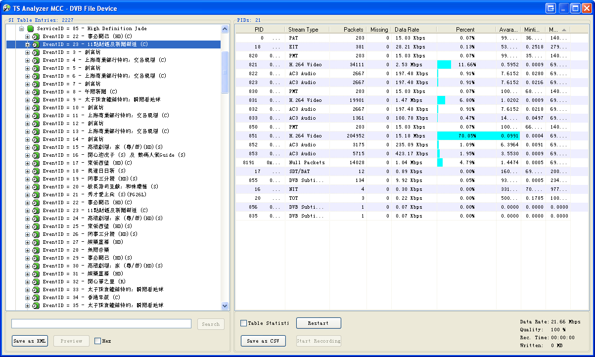

hackbart Posted March 14, 2008 Posted March 14, 2008 Does this make any sense? Because it does not for me I installed the simsun font from the office cd (because i read that this font has to be installed if a ansi based chinese display is wanted) and somehow the unicode test string i used completely changed. What is the content of this text (if there is one)? Christian Quote
hackbart Posted March 15, 2008 Posted March 15, 2008 It looks chinese, but somehow i dont think it is ? Christian Quote

sickno Posted March 15, 2008 Posted March 15, 2008 (edited) It looks chinese, but somehow i dont think it is ? Christian By comparing your png with the online schedule, I can confirm that the characters are Traditional Chinese (used in Hong Kong and Taiwan): Hong Kong TVB's HD Jade Schedule Edited March 15, 2008 by sickno Quote

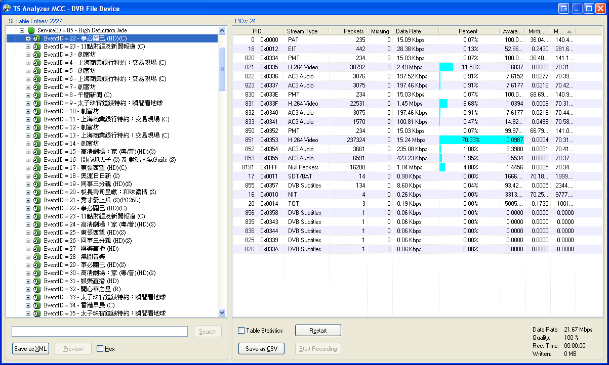

sickno Posted March 15, 2008 Posted March 15, 2008 (edited) Does this make any sense? Because it does not for me I installed the simsun font from the office cd (because i read that this font has to be installed if a ansi based chinese display is wanted) and somehow the unicode test string i used completely changed. What is the content of this text (if there is one)? Christian Christian, The translation is as follows: Bond time - Morning Edition <= in Simplified Chinese (used in mainland China) Bond time - Morning Edition <= in Simplified Chinese (used in mainland China) Deceitful <= A very extremely rarely used Traditional Chinese character - looks like data extraction error? Deceitful??????? <= A very extremely rarely used Traditional Chinese character - ???? may be some data extraction error? Info Link (HD) © <= in Traditional Chinese (used in Hong Kong/Taiwan), (HD)=High Definition, ©=Traditional Chinese EPG Info Link (HD) © <= in Traditional Chinese (used in Hong Kong/Taiwan), (HD)=High Definition, ©=Traditional Chinese EPG Edited March 15, 2008 by sickno Quote
hackbart Posted March 15, 2008 Posted March 15, 2008 Thats what i already thought of Can you have a look at the rest of the text (on the transedit screenshot)? I'ts a bit weird, because according to the specs the code should be big5 encoded, but i was only able to display a text while using gb232. ´ The first text phrase (on the image) is unicode and grabbed by a website i found. The image below is the same text converted to ansi (using charsets). The third line is the epg information i got from a transponder dump and the fourth one the translation to ansi. The last two lines are the same epg information, but i switched the high and low byte, because the ( H D ) information was looking suspicious for this. What i want to know if if the info link is correct and if the second screenshot (with the chinese text) is showing garbage or not.. I will post a text dump of the real epg data - maybe someone is able to get it in a visual readable unicode Christian Quote
sickno Posted March 16, 2008 Posted March 16, 2008 Thats what i already thought of Can you have a look at the rest of the text (on the transedit screenshot)? I'ts a bit weird, because according to the specs the code should be big5 encoded, but i was only able to display a text while using gb232. ´The first text phrase (on the image) is unicode and grabbed by a website i found. The image below is the same text converted to ansi (using charsets). The third line is the epg information i got from a transponder dump and the fourth one the translation to ansi. The last two lines are the same epg information, but i switched the high and low byte, because the ( H D ) information was looking suspicious for this. What i want to know if if the info link is correct and if the second screenshot (with the chinese text) is showing garbage or not.. I will post a text dump of the real epg data - maybe someone is able to get it in a visual readable unicode Christian Christian, Have you tried to install arialuni or mingliu font from your office cd and see if you are able to display a text with big5 encoding? For some reason, simsun font can display some traditional chinese characters, but not all of them, may be because part the font file was made in Taiwan? I dont know. Quote
sickno Posted March 16, 2008 Posted March 16, 2008 Christian, As for your information, the first and second line seems to be coming from CCTV, a mainland china broadcaster (gb2312 encoding), and the programme link is: http://www.cctv.com/program/zgzq_new/02/index.shtml The third and forth line is obviously wrong. The fifth and sixth line is coming from Hong Kong's TVB HD Jade Channel, with Big5/unicode encoding, and the programme link is: http://infolink.tvb.com/video/providevideoindex.php I understand you do not read chinese, but i provide the links above because both of the pages have put their programme name in jpg file, so that hopefully you can verify yourself visually BTW which one is the transedit screenshot? Can you give me some hints so that I can verify it for you? Quote

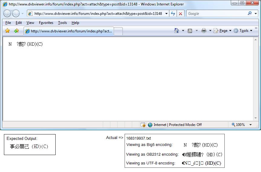

hackbart Posted March 16, 2008 Posted March 16, 2008 I know the third and fourth line is the data transmitted in the epg stream. I realized that this is obviously wrong, because the content was not displayed at all (even for my understanding). The attached text file is for example a text entry in the eit. The first byte is always 0x11 and points you to the information which type of encoding the text is. In this case ISO/IEC 10646-1 Basic Multilingual Plane. The most important thing i need to know is if the screenshot of transedit shows correct information (the chinese text in the screenshot - on the last page). The following screenshot has been taken with mingliu and BIG5 as output: Christian 168319937.txt Quote
sickno Posted March 16, 2008 Posted March 16, 2008 (edited) I know the third and fourth line is the data transmitted in the epg stream. I realized that this is obviously wrong, because the content was not displayed at all (even for my understanding). The attached text file is for example a text entry in the eit. The first byte is always 0x11 and points you to the information which type of encoding the text is. In this case ISO/IEC 10646-1 Basic Multilingual Plane. The most important thing i need to know is if the screenshot of transedit shows correct information (the chinese text in the screenshot - on the last page). The following screenshot has been taken with mingliu and BIG5 as output: Christian Christian, The jpg file output looks OK, but the .txt file is NOT correct. Please have a look at the image attached: (The left bottom part of the image shows the expected output, whereas the bottom right shows what is actually showing in my screen) For the jpg file, all of them are valid Traditional Chinese characters and the translation of the image to English text is as follows: [-] ServiceID = 85 - High Definition Jade [+] EventID = 22 - Info Link (HD)© [+] EventID = 23 - Financial News and News at 11 © [+] EventID = 3 - Money Smart [+] EventID = 4 - Shanghai Comm. Bank Presents: Inside the Stock Exchange © [+] EventID = 5 - Money Smart [+] EventID = 6 - Shanghai Comm. Bank Presents: Inside the Stock Exchange © [+] EventID = 7 - Money Smart [+] EventID = 8 - News at Noon © [+] EventID = 9 - Prince Jewellery & Watch Presents: EARTH LIVE [+] EventID = 10 - Money Smart [+] EventID = 11 - Shanghai Comm. Bank Presents: Inside the Stock Exchange © [+] EventID = 12 - Money Smart [+] EventID = 13 - Shanghai Comm. Bank Presents: Inside the Stock Exchange © [+] EventID = 14 - Money Smart [+] EventID = 15 - High Definition Drama: Home (Cantonese/Mandarin)(HD)(S) [+] EventID = 16 - Happy Chinese New Year of "Earth" "Mouse" (S) and Digital Buzz Guide (S) [+] EventID = 17 - Scoop (HD)© [+] EventID = 18 - Olympics Daily (S) [+] EventID = 19 - Best Selling Secrets (HD)(S) [+] EventID = 20 - Itacho Sushi Presents: Wasabi Mon Amour (S) [+] EventID = 21 - The Gentle Crackdown II (S)(PG26L) [+] EventID = 22 - Info Link (HD)© [+] EventID = 23 - Financial News and News at 11 © [+] EventID = 24 - High Definition Drama: Home (Cantonese/Mandarin)(HD)(S) [+] EventID = 25 - Scoop (HD)© [+] EventID = 26 - Best Selling Secrets (HD)(S) [+] EventID = 27 - E-Buzz (HD) [+] EventID = 28 - Global Rhythm [+] EventID = 29 - Info Link (HD)© [+] EventID = 30 - High Definition Drama: Home (Cantonese/Mandarin)(HD)(S) [+] EventID = 31 - E-Buzz (HD) [+] EventID = 32 - Mind Our Own Business ® [+] EventID = 33 - Prince Jewellery & Watch Presents: EARTH LIVE [+] EventID = 34 - Good Morning Hong Kong © [+] EventID = 35 - Prince Jewellery & Watch Presents: EARTH LIVE Edited March 16, 2008 by sickno Quote
hackbart Posted March 16, 2008 Posted March 16, 2008 Wow, thanks thats what i wanted to hear. The bytes inside the text file are not correct, in order to display the content properly you have to change the first with the second, the third with the fourth etc. Anyway it is good to hear that it works, so the next release might be able to display the chinese epg in the right way. I keep you informed Christian Quote
Lars_MQ Posted March 16, 2008 Posted March 16, 2008 @Christian: They are correct. You just forgot the hi/lo byteordner in DVB-Stream is reversed to Intel PCs Quote
