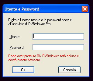

Request login continues

Uninstall the DVBViewer. Afterwards start regedit and delete the entry at HLKM/software/cm&v. Then try re-installing the DVBViewer with the credentials you received after your purchase.

I did not enter the username and password when asked again.
Next time I started the program the credentials were NOT in the registry!
