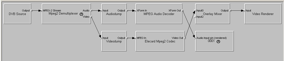

somehow I don't seem to be able to get a sound with DVBViewer sourcefilter. I think, the very first time i used it, I heard a sound, if I remember correctly. But after that, all efforts to fix the problem failed (even reinstalling).
Could someone give me an idea, where to look.
The DVBSource filter only connects to the MPEG audio decoder (the M$ decoder in quartz.dll). Maybe unregistered... how does the graph look like?
Griga
The qraph seems ok. Maybe it's the sound PID. I noticed that channelscan does neither set PMT nor diseqC correctly. I had to correct it manually.
Thanks in advance for helping!
No clue... I tried it exactly with the same graph on my computer (except the audio renderer), and it works. The audio PID... very unlikely. Without the correct audio PID video won't run either.
So I simply don't know - sorry.
Griga
ok, thanks for replying anyhow. So I'll do a little experimenting with the audio renderer.
