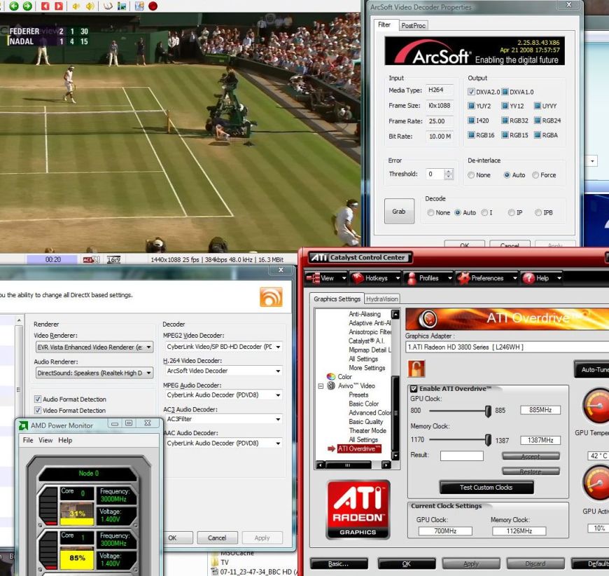

Hi, I am using DXVA 2.0 ((via Arcsoft software) and it seems OK. I enclose a picture with info about various items. The thing that I am not sure about is wheter my Video card is configured correctly. CPU Core1 seems fairly busy but ATI card is only at 10%.. Does this mean the ATI card is not handling the hardware acceleration?
Your comments appreciated
Hmmm, GPU is clocked at 700 MHz, so quite some things seem to be going on their. You can't see the load that the H.264 decoding puts onto the GPU as this is not done within the shaders but within a co-video-processor (UVD). What you see is the load of the deinterlacing pixelshader. But 10% seems quite low. My 3650 is at about 40% for 1080i material (clocked at 600 MHz and with less shaders compared to your 3870). But CPU usage seems to high.
CyberLink PowerDVD H.264 decoder also seems quite good when it comes to DXVA.

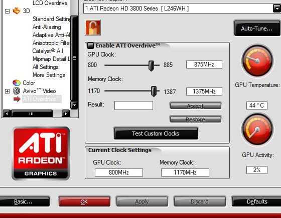

Hi, not sure what happened to the GPU clock. I have just done the auto tune on the HD3870 and it is now showing correctly. I have also selected Cyberlink H.264 decoder (use DxVA ticked and I have chosen Force Bob) seem to work OK. Watching BBC HD and GPU is at 4%. Thanks for the advice.
Forgot the picture after auto tune in CC ...
Why do you do that? Put it to Auto..
You can now open the CyberLink H.264 decoder properties while CTRL being pressed. Then you see the extended properties. The ATi is decoding if profile is 'Bitstream'.
CPU usage should be pretty low now and GPU usage higher than on the above screenshot due to 'Auto' Deinterlacing which uses the pixelshaders to deinterlace in case of DXVA.

Have unravelled the mystery of the ATI GPU clock. After Mine went back to 700Mhz I thought I had a problem.
The GPU clock on the latest ATI cards will fall back to a slower speed when the GPU is not been used very hard.
I tested this out by running the demo version of CRYSIS at High Setting and if you open up CCC (the overclock Page) you will see the clock changing frequency and yes at one point it went up very high 875 and at 99% ...... and it survived.
I also had DVBViewer running an HD channel - Media Theatre running a DVD and media player playing a video and the ATI card coped admirably - the last item was running in a second screen .......
