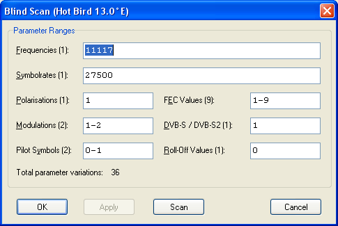

You can find the correct DVB-S2 parameters for your FireDTV S2 and a particular DVB-S2 transponder by performing a blind scan with TransEdit (see members area) over just one frequency, provided the frequency, symbolrate and polarisation are known.
Your input in the Blind Scan Window should look like this (just an example for Hotbird 11117 H, SR 27500 - adjust it to your transponders in question):
That works, thanks!
