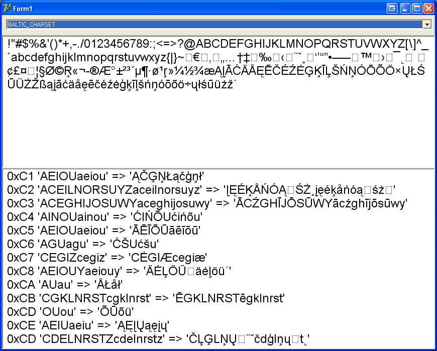

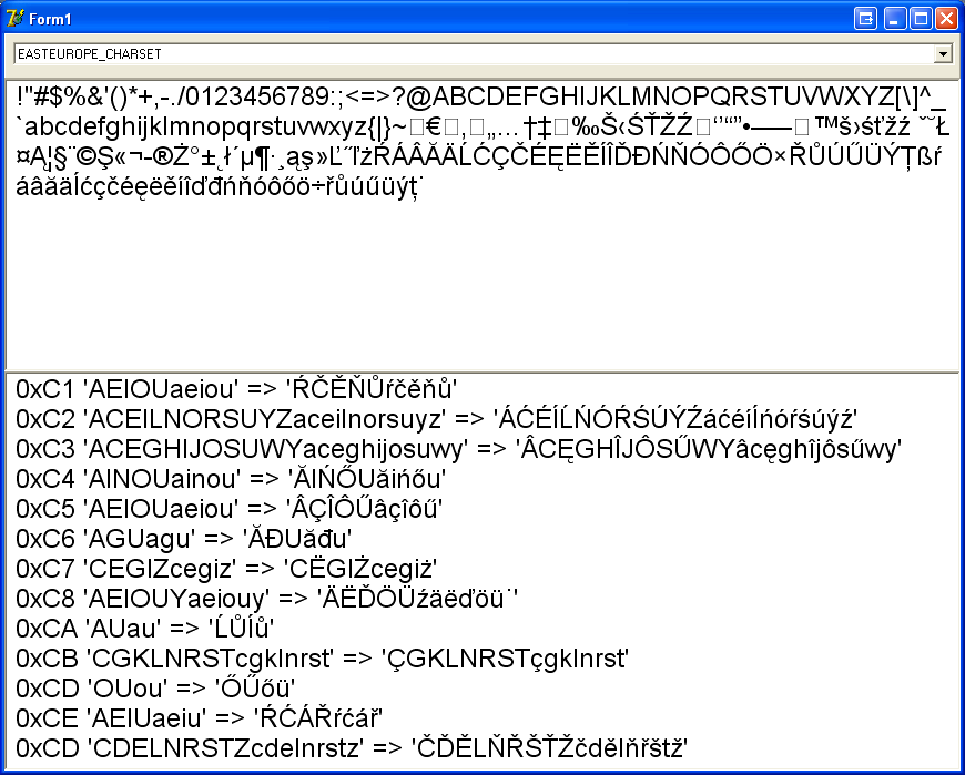

hackbart Posted June 20, 2008 Posted June 20, 2008 Lets explain this a bit more in detail: The "ring" thing stands for the rest of the whole problem: Å Å® å ů While Å can be found on swedish and finnish language, the Å® for example in other eastern europe languages (e.g. czech). Both are listed in code table 0xCA, but instead of an Å you have a different sign listed while using EASTEUROPE_CHARSET. The same is for the Å® in other charsets. Anyway i implemented something in the hope to get almost rid of the problem since its pretty unlikely that both characters are used in a language which does not contain this character in a regular way. If you want to know how the code pages are look alike: 0xC1 'AEIOUaeiou' => 'ÀÈÌÒÙàèìòù' 0xC2 'ACEILNORSUYZaceilnorsuyz' => 'ÁÆÉÍÅÑÓÀÅ’ÚÝ�áæéíåñóàÅ“úýŸ' 0xC3 'ACEGHIJOSUWYaceghijosuwy' => 'ÂCÊGHÎJÔSÛWYâcêghîjôsûwy' 0xC4 'AINOUainou' => 'ÃIÑÕUãiñõu' 0xC5 'AEIOUaeiou' => 'ÂÇÎÔÛâçîôû' 0xC6 'AGUagu' => 'ÃÐUãðu' 0xC7 'CEGIZcegiz' => 'CËGI¯cegi¿' 0xC8 'AEIOUYaeiouy' => 'ÄËÏÖÜŸäëïöüÿ' 0xCA 'AUau' => 'ÅÙåù' 0xCB 'CGKLNRSTcgklnrst' => 'ÇGKLNRSTçgklnrst' 0xCD 'OUou' => 'ÕÛõü' 0xCE 'AEIUaeiu' => 'ÀÆÁØàæáø' 0xCD 'CDELNRSTZcdelnrstz' => 'ÈÏÌLÒØÅ ï¿½Å½èdìlòøÅ¡tž' Christian PS: Dont wonder why the characters are not displayed correctly in here - it is because your browser probably likes Unicode more. table.txt Quote

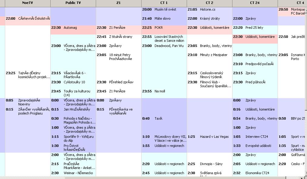

zetka Posted November 6, 2008 Posted November 6, 2008 Maybe another interesting aspect to that theme. Although all three multiplexes sent in the Czech rep. should be coded in ISO 6937 (based upon official info), I see a great difference in the EPG window for the CDG Multiplex 3 (Noe, Public TV, Ocko) to the other ones. I have asked CDG technical support and I have got the information which can be interesting and a reason, why DVBViewer reacts different for the same coded EPGs. They told, that the norm allows to describe the language description by code CZE or CES. The Czech TV multiplexes use description CZE but the CDG uses CES. Because lots of setoppboxes ingnore this second allowed description, they have problems with recognizing and displaying the right EPG language. Is not this a similar problem why there are differences, although the norm is (or should be) the same? Regards, Zetka. Attached is the view, the left three are CDG and the right are Czech TV. On the left three there is the effect of inserting a wrong char before the punctuated char, on the second one it is partially correct, but errors are there (for example missing r with hook, inserted char before i with "line")... Quote
