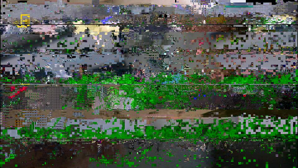

A screenshot from Nat Geo HD:post-57456-1213970127_thumb.jpg
Please help me fix this problem...
GPU is NVIDIA 8800 Ultra, codec used in the screenshot is CoreAVC. NVIDIA Pure Video codecs like PowerDVD 8 just stay black, I do not even get pixelating there.

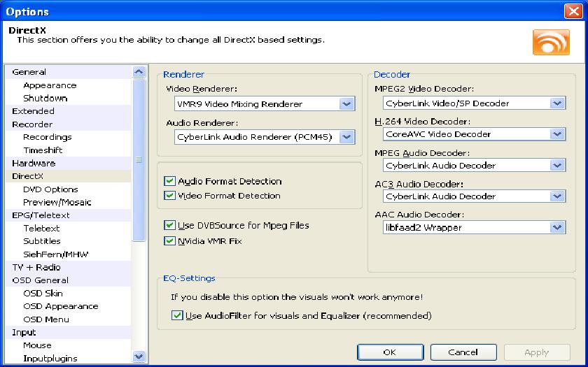

Can you tell me EXACTLY which codes you are using and which setting you have in the DirectX Tab in the Settings please? Screenshot would be the best... Which codecs, which NVDIA VMR settings etc...

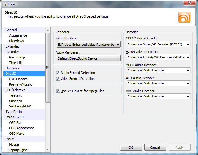

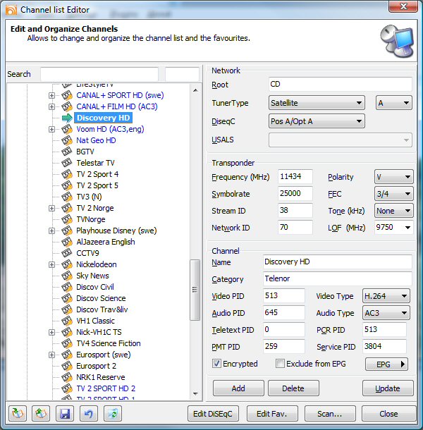

Sorry, I've been away for a few days, but here are screen shots of my dx settings. Also include a picture of Discovery HD channel editor settings.
