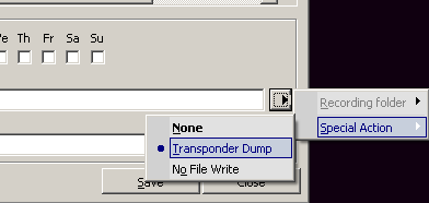

To record the complete transponder in one file you have to edit the timer in the Timer Window.
Thanks for the very quick response Tjod. I was thinking it must be buried away somewhere. Anyway I can now save the whole transponder.
