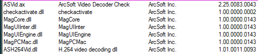

Thanks. I'll do some more experimenting. SysInternals process explorer gave me the following:
I'm guessing maybe I have a later version than you, and I must say that "checkactivate.dll" is a little ominous!
